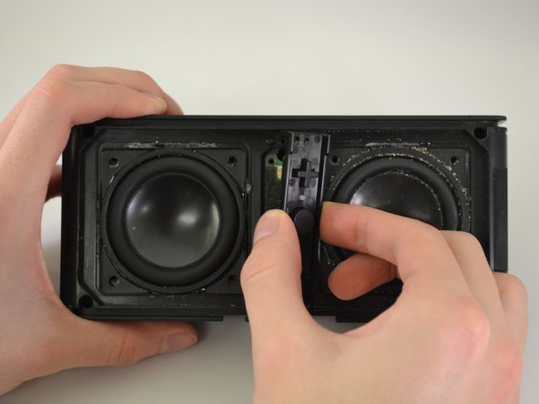

    • Starting with the corners, gently pull the rubber cover off of the device.
  2. Skullcandy Air Raid Buttons Replacement, Handle: crwdns2935265:02crwdnd2935265:01crwdnd2935265:01crwdne2935265:0
    • Using the T-6 hexagonal screwdriver, unscrew the four 10mm #6 hex screws on the right side of the device.
    • Remove the handle from the device.
  3. Skullcandy Air Raid Buttons Replacement, Front Plate: crwdns2935265:03crwdnd2935265:01crwdnd2935265:01crwdne2935265:0
    • Unscrew the two screws on the left side of the device using the phillips #00 screwdriver.
    • One 5mm Phillips screw.
    • One 8mm Phillips screw.
  4. Skullcandy Air Raid Buttons Replacement: crwdns2935265:04crwdnd2935265:01crwdnd2935265:01crwdne2935265:0
    • Gently pull the sides of the front plate outwards from the device.
    • Pull up on the front plate to remove it from the device.
  5. Skullcandy Air Raid Buttons Replacement, Control Buttons: crwdns2935265:05crwdnd2935265:01crwdnd2935265:02crwdne2935265:0 Skullcandy Air Raid Buttons Replacement, Control Buttons: crwdns2935265:05crwdnd2935265:02crwdnd2935265:02crwdne2935265:0
    • Using a Phillips #00 Precision Screwdriver, unscrew two 6 mm screws from the middle of the panel, specifically above and below the volume buttons.
    • Lift the button panel.
  6. Skullcandy Air Raid Buttons Replacement, Button Motherboard: crwdns2935265:06crwdnd2935265:01crwdnd2935265:01crwdne2935265:0
    • Using a Phillips #00 Precision Screwdriver, unscrew two 6 mm screws from the button motherboard.
  7. Skullcandy Air Raid Buttons Replacement: crwdns2935265:07crwdnd2935265:01crwdnd2935265:01crwdne2935265:0
    • Using a plastic opening tool, pry up on the button motherboard to detach it from the device.
    • The button motherboard is connected to a ribbon cable inside the device.
  8. Skullcandy Air Raid Buttons Replacement, Ribbon Cable: crwdns2935265:08crwdnd2935265:01crwdnd2935265:01crwdne2935265:0
    • First, pull on the black attachment to disconnect it from the metal piece.
    • Release the cable from the back of the motherboard.
    • The black attachment is a part of the connector, not the blue ribbon cable. It will not disconnect from the motherboard.
