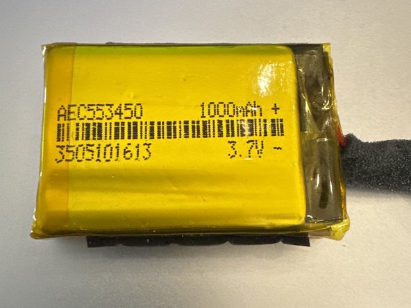

    1. Skullcandy Air Raid Battery Replacement, Battery: crwdns2935265:015crwdnd2935265:01crwdnd2935265:01crwdne2935265:0
      • Pull on the ribbon cable that connects the battery to the motherboard until the connector releases.
    2. Skullcandy Air Raid Battery Replacement, Removing Battery: crwdns2935265:016crwdnd2935265:01crwdnd2935265:01crwdne2935265:0
      • Pull battery straight out until it is completely out of device.
      • If you are unable to loosen glue contact, use a heat gun to assist in removal.
    3. Skullcandy Air Raid Battery Replacement, Battery selection: crwdns2935265:017crwdnd2935265:01crwdnd2935265:01crwdne2935265:0
      • The battery has 3 wires - the middle white wire is to prevent overheating so look for a 3 wire replacement battery.
    4. Skullcandy Air Raid Battery Replacement, Replacement battery adaptation: crwdns2935265:018crwdnd2935265:01crwdnd2935265:02crwdne2935265:0 Skullcandy Air Raid Battery Replacement, Replacement battery adaptation: crwdns2935265:018crwdnd2935265:02crwdnd2935265:02crwdne2935265:0
      • If you aren't able to source an official replacement battery, follow the next two steps for tips on alternate battery replacements.
      • This is actually 2 × 1000mAh 3.7V batteries. The total is 2000mAhm, or 7.4Wh. The battery compartment is the limiting factor, so a replacement should be 10mm deep, 54mm long and 34mm wide.
    5. Skullcandy Air Raid Battery Replacement: crwdns2935265:019crwdnd2935265:01crwdnd2935265:03crwdne2935265:0 Skullcandy Air Raid Battery Replacement: crwdns2935265:019crwdnd2935265:02crwdnd2935265:03crwdne2935265:0 Skullcandy Air Raid Battery Replacement: crwdns2935265:019crwdnd2935265:03crwdnd2935265:03crwdne2935265:0
      • If you have a replacement battery picked out, you can remove and reorder the wires to fit the original connector. Pictured is an example replacement. This battery requires cutting and soldering the 3 leads from the old battery.

It is a rechargeable battery Model AEC553450-2P / 2000mA 3.7V 7.4Wh.
