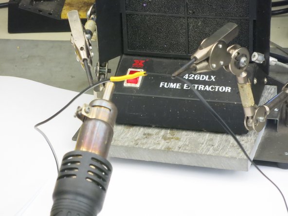

  3. SkullCandy INK'D 2 Audio Jack Replacement: crwdns2935265:03crwdnd2935265:01crwdnd2935265:01crwdne2935265:0
    Heat Shrink Tubing Assortment
    $7.99
    • Put shrink tubing on either one of the wires.
    • For each wire color, put the headphone wire and the replacement wire into clamps. Weave them together using fingers.
    • Review the soldering guide before initiating Step 4.

  6. SkullCandy INK'D 2 Audio Jack Replacement: crwdns2935265:06crwdnd2935265:01crwdnd2935265:03crwdne2935265:0 SkullCandy INK'D 2 Audio Jack Replacement: crwdns2935265:06crwdnd2935265:02crwdnd2935265:03crwdne2935265:0 SkullCandy INK'D 2 Audio Jack Replacement: crwdns2935265:06crwdnd2935265:03crwdnd2935265:03crwdne2935265:0
    Heat Gun
    $24.99
    • After all wires are soldered, cover them with shrink tubing.
    • Use the heat gun to shrink the tubing and fit it tightly around the wires.
    • Gently apply heat in order to shape the tubing around the soldered wires.
