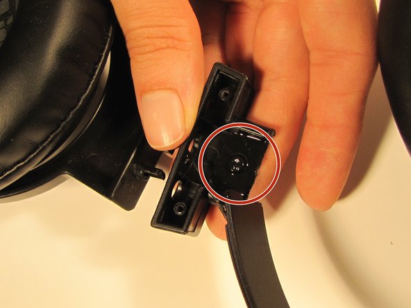

    • Locate the break in the device.
  2. SkullCandy Hesh Size Adjuster Replacement: crwdns2935265:02crwdnd2935265:01crwdnd2935265:01crwdne2935265:0
    • Use a Phillips #0 screwdriver to remove the two 9 mm screws from the bottom inner casing beneath the break.
  3. SkullCandy Hesh Size Adjuster Replacement: crwdns2935265:03crwdnd2935265:01crwdnd2935265:01crwdne2935265:0
    • Remove the bottom inner casing to reveal the wire compartment and the port where the slider inserts.
  4. SkullCandy Hesh Size Adjuster Replacement: crwdns2935265:04crwdnd2935265:01crwdnd2935265:02crwdne2935265:0 SkullCandy Hesh Size Adjuster Replacement: crwdns2935265:04crwdnd2935265:02crwdnd2935265:02crwdne2935265:0
    • Cover the detached slider port in a generous layer of Plasti Dip, which works like glue. Also coat any exposed wire to seal the circuit.
  5. SkullCandy Hesh Size Adjuster Replacement: crwdns2935265:05crwdnd2935265:01crwdnd2935265:01crwdne2935265:0
    • Realign the broken size adjuster into the port with the Plasti Dip so that it can be secured to the ear piece.
  6. SkullCandy Hesh Size Adjuster Replacement: crwdns2935265:06crwdnd2935265:01crwdnd2935265:01crwdne2935265:0
    • Clamp the pieces in place by hand or with a binder clip until the Plasti Dip dries. Feel free to use a hair dryer on a low setting to speed up the process.
To reassemble your device, reattach the bottom inner casing with the Phillips #0 screwdriver and two removed screws.
