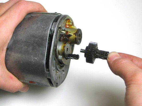

    1. Skil 88 Motor Replacement, Motor: crwdns2935265:03crwdnd2935265:01crwdnd2935265:02crwdne2935265:0 Skil 88 Motor Replacement, Motor: crwdns2935265:03crwdnd2935265:02crwdnd2935265:02crwdne2935265:0
      • Remove the gear that is threaded onto the divider.
    2. Skil 88 Motor Replacement: crwdns2935265:04crwdnd2935265:01crwdnd2935265:02crwdne2935265:0 Skil 88 Motor Replacement: crwdns2935265:04crwdnd2935265:02crwdnd2935265:02crwdne2935265:0

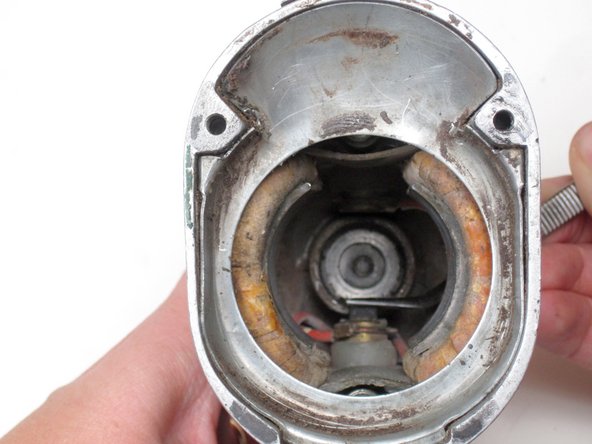

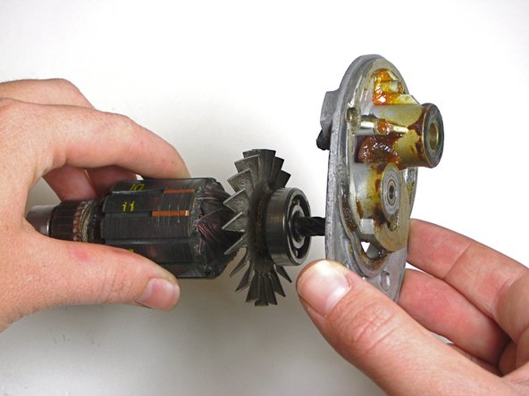

      • Remove the divider from the rear housing.
      • The motor may come out along with the divider.

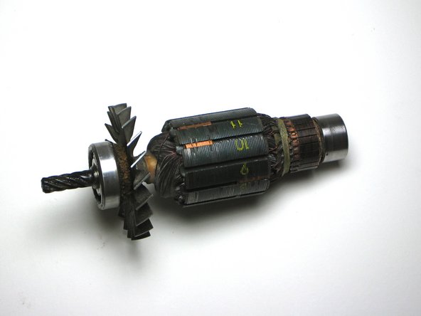

    3. Skil 88 Motor Replacement: crwdns2935265:05crwdnd2935265:01crwdnd2935265:02crwdne2935265:0 Skil 88 Motor Replacement: crwdns2935265:05crwdnd2935265:02crwdnd2935265:02crwdne2935265:0
      • Pull out the motor.

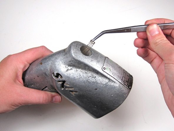

    4. Skil 88 Motor Replacement: crwdns2935265:06crwdnd2935265:01crwdnd2935265:03crwdne2935265:0 Skil 88 Motor Replacement: crwdns2935265:06crwdnd2935265:02crwdnd2935265:03crwdne2935265:0 Skil 88 Motor Replacement: crwdns2935265:06crwdnd2935265:03crwdnd2935265:03crwdne2935265:0
      • For reassembly, remove the orange cap on top using your flathead screwdriver. A bushing should come out with it.
      • Depress the bushing on bottom using the tweezers. To reach the bushing you will have to put the tweezers through the "Skil" lettering. Insert the motor as it is depressed.
      • Using the tweezers, place the other bushing back in through the hole in the top. Screw the orange cap back on.
To continue reassembly, simply follow the guide backwards starting at step 2.
