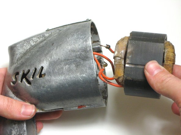

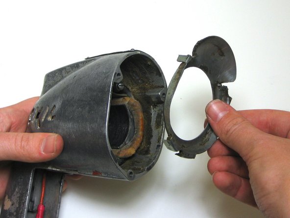

  5. Skil 88 Motor Housing Replacement, Motor Housing: crwdns2935265:05crwdnd2935265:01crwdnd2935265:02crwdne2935265:0 Skil 88 Motor Housing Replacement, Motor Housing: crwdns2935265:05crwdnd2935265:02crwdnd2935265:02crwdne2935265:0
    • Remove the inner divider.
  6. Skil 88 Motor Housing Replacement: crwdns2935265:06crwdnd2935265:01crwdnd2935265:01crwdne2935265:0
    • Remove the two 1" flathead screws located at the top and bottom of the motor housing.
  7. Skil 88 Motor Housing Replacement: crwdns2935265:07crwdnd2935265:01crwdnd2935265:02crwdne2935265:0 Skil 88 Motor Housing Replacement: crwdns2935265:07crwdnd2935265:02crwdnd2935265:02crwdne2935265:0
    • Pull the motor housing out.
    • The wires from the trigger housing should follow the motor housing.

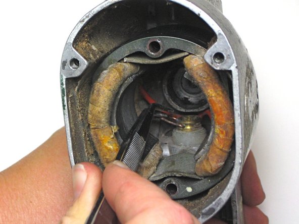

  8. Skil 88 Motor Housing Replacement: crwdns2935265:08crwdnd2935265:01crwdnd2935265:02crwdne2935265:0 Skil 88 Motor Housing Replacement: crwdns2935265:08crwdnd2935265:02crwdnd2935265:02crwdne2935265:0
    • After you have placed the motor housing back into the drill during reassembly, thread the wires down to the handle using tweezers.
    • Plug the forked wire into the socket at the back of the motor housing using tweezers.
To continue reassembly, simply follow the guide backwards starting at step 2.
