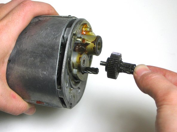

Is your motor running but the drill is not turning? Replace those gears to start providing torque to your drill bit.
    1. Skil 88 Gears Replacement, Disassembling Skil 88 Front Housing: crwdns2935265:01crwdnd2935265:01crwdnd2935265:01crwdne2935265:0
      • On the front of the drill, remove the three 2" flathead screws connecting the front housing to the rear housing.
    2. Skil 88 Gears Replacement: crwdns2935265:02crwdnd2935265:01crwdnd2935265:02crwdne2935265:0 Skil 88 Gears Replacement: crwdns2935265:02crwdnd2935265:02crwdnd2935265:02crwdne2935265:0
      • Pull the front housing apart from the rear.
      • The motor and gears might fall out when you are pulling it apart.
    1. Skil 88 Gears Replacement, Gears: crwdns2935265:03crwdnd2935265:01crwdnd2935265:02crwdne2935265:0 Skil 88 Gears Replacement, Gears: crwdns2935265:03crwdnd2935265:02crwdnd2935265:02crwdne2935265:0
      • Remove gear from the divider and add the new gear.
