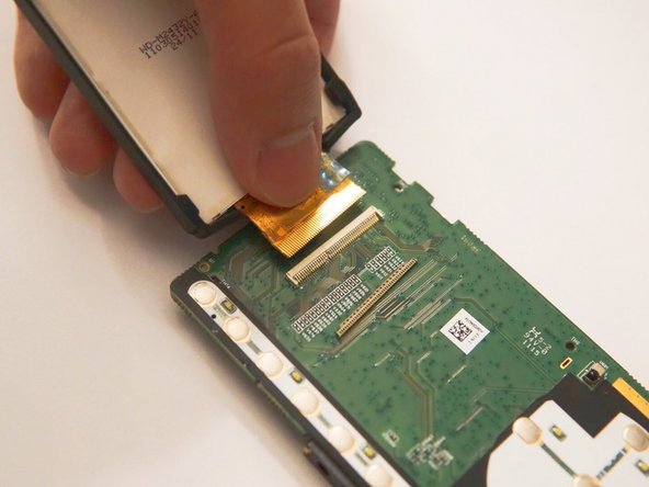

    • Take the iFixit opening tool and place it between the crevice as shown.
  2. SiriusXM Onyx Screen Replacement: crwdns2935265:02crwdnd2935265:01crwdnd2935265:02crwdne2935265:0 SiriusXM Onyx Screen Replacement: crwdns2935265:02crwdnd2935265:02crwdnd2935265:02crwdne2935265:0
    • Apply pressure to the iFixit opening tool, pushing down until the the plastic casing pops off.
  3. SiriusXM Onyx Screen Replacement: crwdns2935265:03crwdnd2935265:01crwdnd2935265:02crwdne2935265:0 SiriusXM Onyx Screen Replacement: crwdns2935265:03crwdnd2935265:02crwdnd2935265:02crwdne2935265:0
    • Use the Phillips PH00 to remove the three marked screws.
  4. SiriusXM Onyx Screen Replacement: crwdns2935265:04crwdnd2935265:01crwdnd2935265:03crwdne2935265:0 SiriusXM Onyx Screen Replacement: crwdns2935265:04crwdnd2935265:02crwdnd2935265:03crwdne2935265:0 SiriusXM Onyx Screen Replacement: crwdns2935265:04crwdnd2935265:03crwdnd2935265:03crwdne2935265:0
    • Once the screws have been removed, the motherboard is free to come out.

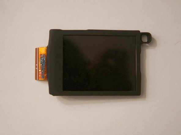

  5. SiriusXM Onyx Screen Replacement, Screen: crwdns2935265:05crwdnd2935265:01crwdnd2935265:03crwdne2935265:0 SiriusXM Onyx Screen Replacement, Screen: crwdns2935265:05crwdnd2935265:02crwdnd2935265:03crwdne2935265:0 SiriusXM Onyx Screen Replacement, Screen: crwdns2935265:05crwdnd2935265:03crwdnd2935265:03crwdne2935265:0
    • Remove the plastic case in front of the socket using the spudger.
    • Hold the screen and gently pull in the direction of the cable to separate screen from the socket.
