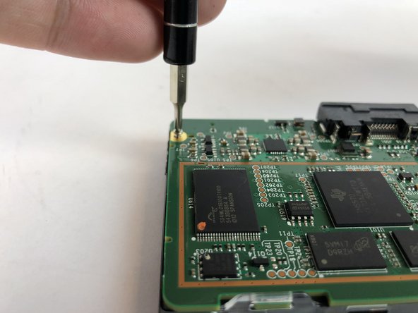

  4. SiriusXM Onyx Plus Motherboard Replacement, Motherboard: crwdns2935265:04crwdnd2935265:01crwdnd2935265:02crwdne2935265:0 SiriusXM Onyx Plus Motherboard Replacement, Motherboard: crwdns2935265:04crwdnd2935265:02crwdnd2935265:02crwdne2935265:0
    • Remove the three 5.4mm JIS #00 screws from the motherboard.
