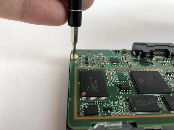

  4. SiriusXM Onyx Plus Buttons Replacement, Buttons: crwdns2935265:04crwdnd2935265:01crwdnd2935265:02crwdne2935265:0 SiriusXM Onyx Plus Buttons Replacement, Buttons: crwdns2935265:04crwdnd2935265:02crwdnd2935265:02crwdne2935265:0
    • Remove the three 5mm JIS #00 screws from the motherboard.

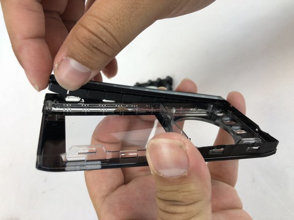

  7. SiriusXM Onyx Plus Buttons Replacement: crwdns2935265:07crwdnd2935265:01crwdnd2935265:02crwdne2935265:0 SiriusXM Onyx Plus Buttons Replacement: crwdns2935265:07crwdnd2935265:02crwdnd2935265:02crwdne2935265:0
    • Holding the front casing in your hand, push the button panels out of the casing.
    • There are two buttons panels: Navigation panel and the Channel Number panel
