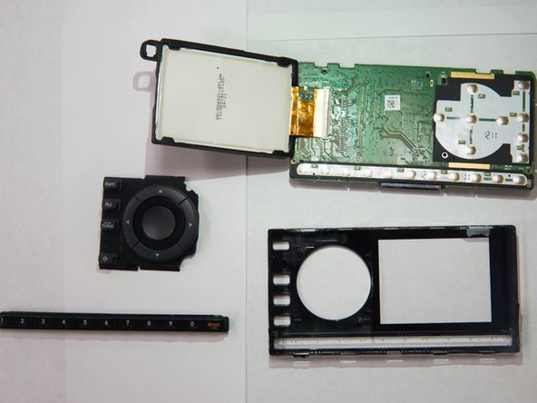

    • Take the iFixit opening tool and place it between the crevice as shown.
  2. SiriusXM Onyx Motherboard Replacement: crwdns2935265:02crwdnd2935265:01crwdnd2935265:02crwdne2935265:0 SiriusXM Onyx Motherboard Replacement: crwdns2935265:02crwdnd2935265:02crwdnd2935265:02crwdne2935265:0

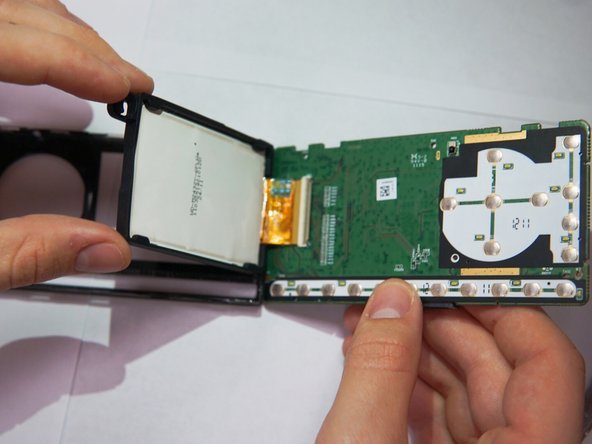

    • Apply pressure to the iFixit opening tool, pushing down until the the plastic casing pops off.
  3. SiriusXM Onyx Motherboard Replacement: crwdns2935265:03crwdnd2935265:01crwdnd2935265:02crwdne2935265:0 SiriusXM Onyx Motherboard Replacement: crwdns2935265:03crwdnd2935265:02crwdnd2935265:02crwdne2935265:0

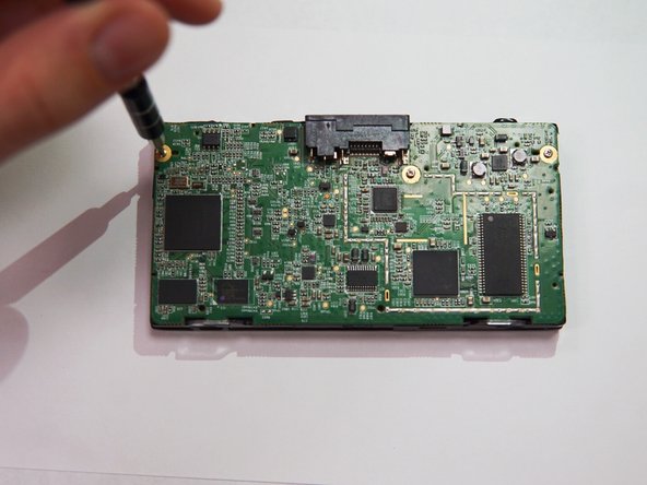

    • Use the Phillips PH00 to remove the three marked screws.
  4. SiriusXM Onyx Motherboard Replacement: crwdns2935265:04crwdnd2935265:01crwdnd2935265:03crwdne2935265:0 SiriusXM Onyx Motherboard Replacement: crwdns2935265:04crwdnd2935265:02crwdnd2935265:03crwdne2935265:0 SiriusXM Onyx Motherboard Replacement: crwdns2935265:04crwdnd2935265:03crwdnd2935265:03crwdne2935265:0
    • Once the screws have been removed, the motherboard is free to come out.
