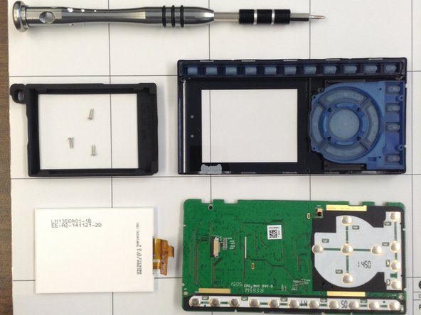

    • This will leave the back of the main board exposed.
    • Unscrew the (3) Philips head screws with a PH000 Philips head screwdriver from the iFixit kit to remove the main board.
    • Save the screws. You will need them to reassemble the device.

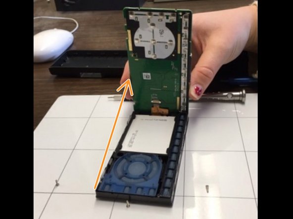

    • Slide the main board towards the base of the unit away from the two clear clips at the top.
    • Once unclipped pull the board from the left side towards the right, exposing the LCD display.

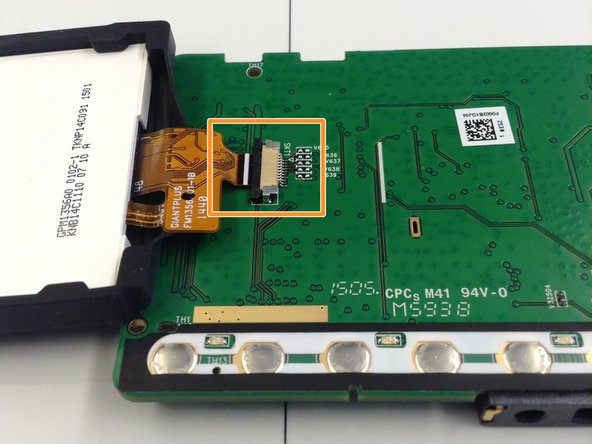

  4. SiriusXM Onyx EZ Main Board Replacement: crwdns2935265:04crwdnd2935265:01crwdnd2935265:01crwdne2935265:0
    • Lift up LCD display out of front casing.
    • At this point, refer to the LCD replacement guide if this is this part you wish to repair.
    • Make sure to remove the main board and the LCD display together as a single unit.
  5. SiriusXM Onyx EZ Main Board Replacement: crwdns2935265:05crwdnd2935265:01crwdnd2935265:03crwdne2935265:0 SiriusXM Onyx EZ Main Board Replacement: crwdns2935265:05crwdnd2935265:02crwdnd2935265:03crwdne2935265:0 SiriusXM Onyx EZ Main Board Replacement: crwdns2935265:05crwdnd2935265:03crwdnd2935265:03crwdne2935265:0

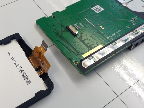

    • Disconnect the LCD display from the main board by gently pulling the brown tab out of the main board’s metal slot.
    • You can now discard the main board and replace it with your new one.
  6. SiriusXM Onyx EZ Main Board Replacement: crwdns2935265:06crwdnd2935265:01crwdnd2935265:02crwdne2935265:0 SiriusXM Onyx EZ Main Board Replacement: crwdns2935265:06crwdnd2935265:02crwdnd2935265:02crwdne2935265:0
    • Attach the LCD Display to the main board by sliding the display's brown tab into the metal slot on the main board.
    • Place the LCD Display back into the front casing of the device, and slide the main board back into the two clear clips.
