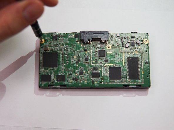

    • Use the Phillips PH00 screwdriver to remove the three marked screws.

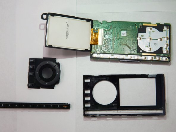

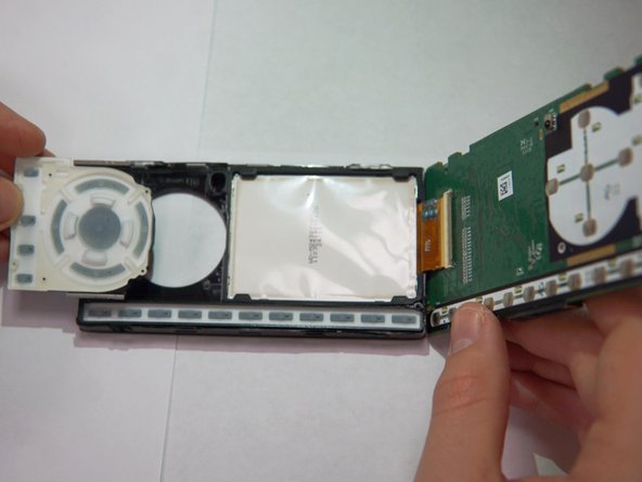

    • Remove the buttons from the casing.
  5. SiriusXM Onyx Casing Replacement: crwdns2935265:05crwdnd2935265:01crwdnd2935265:02crwdne2935265:0 SiriusXM Onyx Casing Replacement: crwdns2935265:05crwdnd2935265:02crwdnd2935265:02crwdne2935265:0
    • Remove the motherboard, and the casing should be free.
