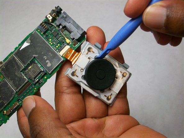

  5. Sirius Stiletto 2 Scroll Wheel Replacement, Scroll Wheel: crwdns2935265:05crwdnd2935265:01crwdnd2935265:02crwdne2935265:0 Sirius Stiletto 2 Scroll Wheel Replacement, Scroll Wheel: crwdns2935265:05crwdnd2935265:02crwdnd2935265:02crwdne2935265:0
    • Isolate the scroll wheel assembly
    • Gently pry the four metal tabs outwards, away from the scroll pad.
  6. Sirius Stiletto 2 Scroll Wheel Replacement: crwdns2935265:06crwdnd2935265:01crwdnd2935265:01crwdne2935265:0
    • Once the scroll pad has been released, be careful not to drop the center button. This may damage the spring.
