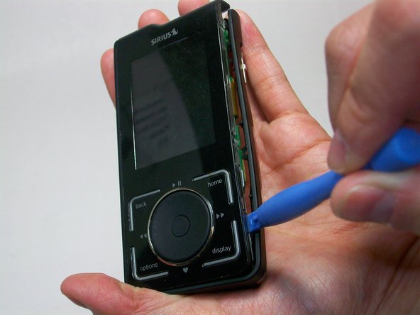

  3. Sirius Stiletto 2 LCD Display Replacement, Front Cover: crwdns2935265:03crwdnd2935265:01crwdnd2935265:01crwdne2935265:0
    • Unscrew the four 6.68mm (1.43mm diameter) Philips #00 screws.
    • If needed, remove the sticker to see the screws
  4. Sirius Stiletto 2 LCD Display Replacement: crwdns2935265:04crwdnd2935265:01crwdnd2935265:02crwdne2935265:0 Sirius Stiletto 2 LCD Display Replacement: crwdns2935265:04crwdnd2935265:02crwdnd2935265:02crwdne2935265:0
    • Start by using a plastic opening tool to loosen the front cover from the sides.
    • Work your way to the bottom of the cover then the top.
    • Carefully pry the front cover off.

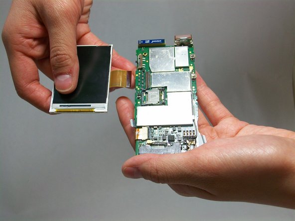

  5. Sirius Stiletto 2 LCD Display Replacement, LCD Display: crwdns2935265:05crwdnd2935265:01crwdnd2935265:01crwdne2935265:0
    • Gently lift the latch on the the ribbon cable connector inward (towards the motherboard).
  6. Sirius Stiletto 2 LCD Display Replacement: crwdns2935265:06crwdnd2935265:01crwdnd2935265:02crwdne2935265:0 Sirius Stiletto 2 LCD Display Replacement: crwdns2935265:06crwdnd2935265:02crwdnd2935265:02crwdne2935265:0
    • Carefully grip the screen and pull it away from the ribbon connector located on the motherboard.
  7. Sirius Stiletto 2 LCD Display Replacement: crwdns2935265:07crwdnd2935265:01crwdnd2935265:01crwdne2935265:0
    • LCD display (left).
