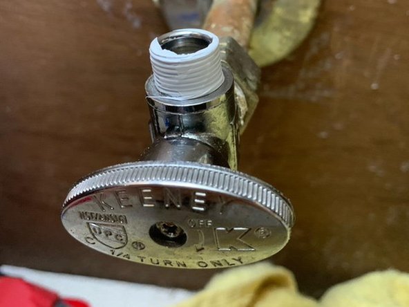

  2. Sink Faucet Water Supply Line Replacement: crwdns2935265:02crwdnd2935265:01crwdnd2935265:03crwdne2935265:0 Sink Faucet Water Supply Line Replacement: crwdns2935265:02crwdnd2935265:02crwdnd2935265:03crwdne2935265:0 Sink Faucet Water Supply Line Replacement: crwdns2935265:02crwdnd2935265:03crwdnd2935265:03crwdne2935265:0

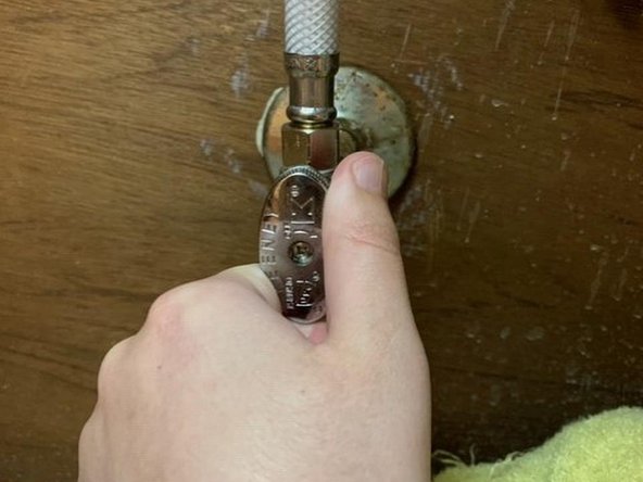

    • Rotate the valve to shut off the water supply to the faucet.
    • A valve is typically considered to be "shut off" when it is perpendicular to the supply line itself. The third photo shows a completely shut off valve.

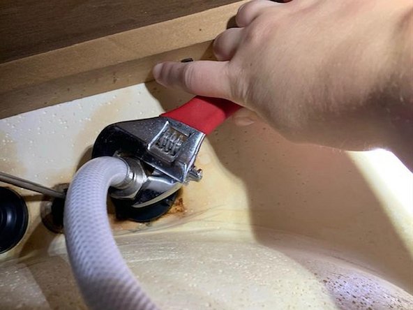

  3. Sink Faucet Water Supply Line Replacement: crwdns2935265:03crwdnd2935265:01crwdnd2935265:03crwdne2935265:0 Sink Faucet Water Supply Line Replacement: crwdns2935265:03crwdnd2935265:02crwdnd2935265:03crwdne2935265:0 Sink Faucet Water Supply Line Replacement: crwdns2935265:03crwdnd2935265:03crwdnd2935265:03crwdne2935265:0

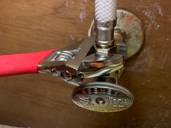

    • Begin unfastening the water supply line, starting with the top of the line attached to the faucet.
    • Place the crescent wrench on the fastening nut, and rotate until the supply line detaches completely from the faucet.

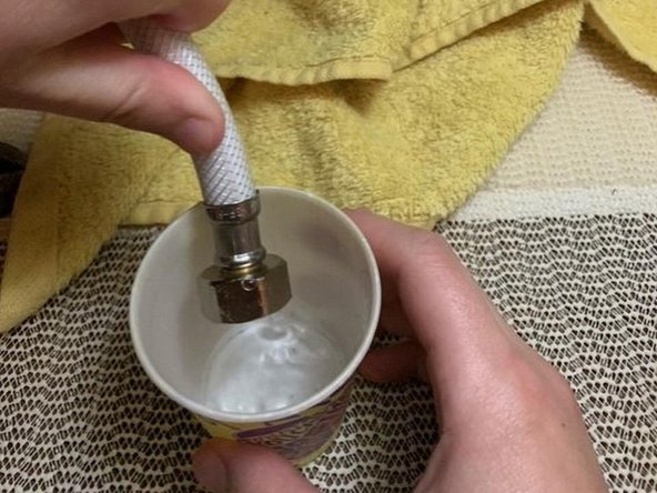

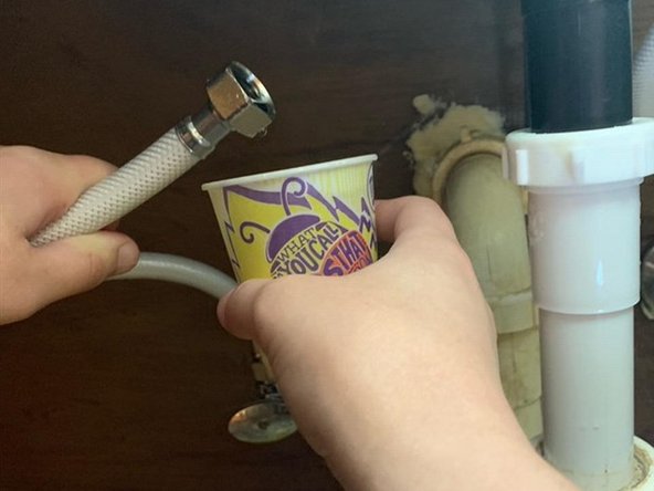

  4. Sink Faucet Water Supply Line Replacement: crwdns2935265:04crwdnd2935265:01crwdnd2935265:03crwdne2935265:0 Sink Faucet Water Supply Line Replacement: crwdns2935265:04crwdnd2935265:02crwdnd2935265:03crwdne2935265:0 Sink Faucet Water Supply Line Replacement: crwdns2935265:04crwdnd2935265:03crwdnd2935265:03crwdne2935265:0
    • Now that the top of the supply line is detached, hold it upright as there will still be some water left in the line from before the valve was shut off.
    • Pour the remaining water from the supply line into a cup to prevent water from spilling elsewhere in the future steps.

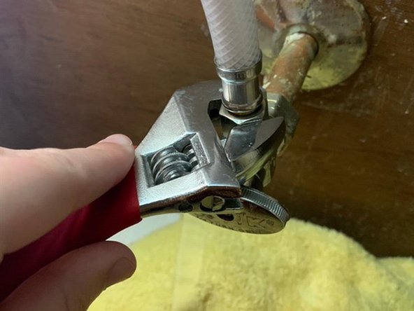

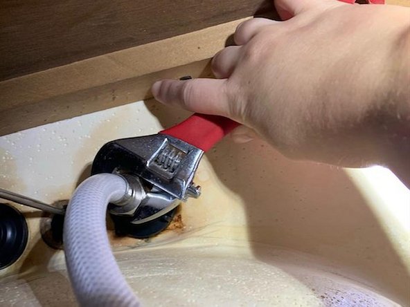

  5. Sink Faucet Water Supply Line Replacement: crwdns2935265:05crwdnd2935265:01crwdnd2935265:03crwdne2935265:0 Sink Faucet Water Supply Line Replacement: crwdns2935265:05crwdnd2935265:02crwdnd2935265:03crwdne2935265:0 Sink Faucet Water Supply Line Replacement: crwdns2935265:05crwdnd2935265:03crwdnd2935265:03crwdne2935265:0
    • Adjust the crescent wrench to fit the bottom nut of the water supply line.
    • Rotate the nut until the water supply line is completely detached from the water supply valve.

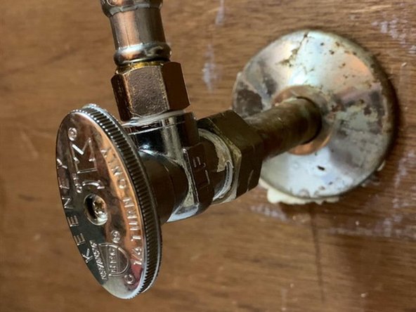

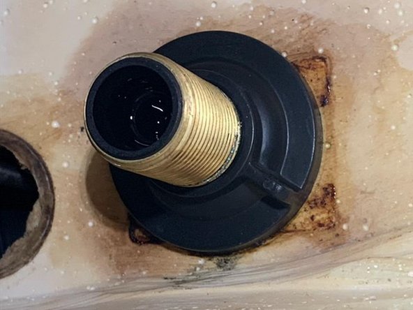

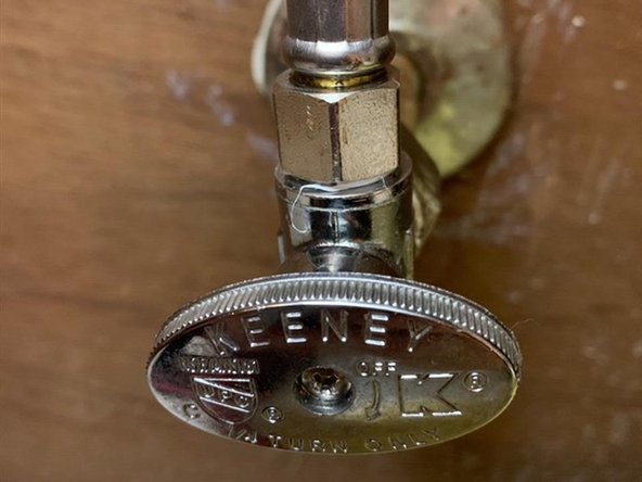

  6. Sink Faucet Water Supply Line Replacement: crwdns2935265:06crwdnd2935265:01crwdnd2935265:03crwdne2935265:0 Sink Faucet Water Supply Line Replacement: crwdns2935265:06crwdnd2935265:02crwdnd2935265:03crwdne2935265:0 Sink Faucet Water Supply Line Replacement: crwdns2935265:06crwdnd2935265:03crwdnd2935265:03crwdne2935265:0
    • Wipe off the connections where the water supply line was previously attached.
    • Completely peel the old Teflon tape from both the top and bottom connections if there is any.

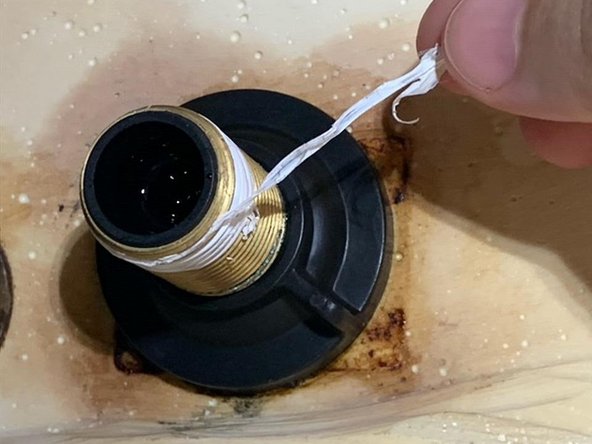

  7. Sink Faucet Water Supply Line Replacement: crwdns2935265:07crwdnd2935265:01crwdnd2935265:02crwdne2935265:0 Sink Faucet Water Supply Line Replacement: crwdns2935265:07crwdnd2935265:02crwdnd2935265:02crwdne2935265:0
    • Wrap the threads of both the top and bottom connections with new Teflon tape.
    • After 2-4 wraps of Teflon tape, tear the tape and secure to the threads.
    • Teflon tape is added to the threads as an effort to reduce the likelihood of leaking at the threads.

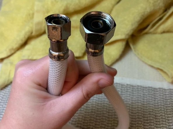

  8. Sink Faucet Water Supply Line Replacement: crwdns2935265:08crwdnd2935265:01crwdnd2935265:03crwdne2935265:0 Sink Faucet Water Supply Line Replacement: crwdns2935265:08crwdnd2935265:02crwdnd2935265:03crwdne2935265:0 Sink Faucet Water Supply Line Replacement: crwdns2935265:08crwdnd2935265:03crwdnd2935265:03crwdne2935265:0
    • Take the new water supply line and connect the bottom fastener first. The connection should be started by hand.
    • After tightening the new water supply line by hand, use the crescent wrench from before to tighten the nut more.
    • A tighter connection means less likelihood of leaks.
  9. Sink Faucet Water Supply Line Replacement: crwdns2935265:09crwdnd2935265:01crwdnd2935265:03crwdne2935265:0 Sink Faucet Water Supply Line Replacement: crwdns2935265:09crwdnd2935265:02crwdnd2935265:03crwdne2935265:0 Sink Faucet Water Supply Line Replacement: crwdns2935265:09crwdnd2935265:03crwdnd2935265:03crwdne2935265:0
    • Place the top portion of the new water supply line to the top fastener. Start reconnecting it by screwing it on by hand.
    • Tighten the connection with the crescent wrench to decrease the likelihood of a future leak.
