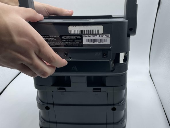

    • Remove the 10 mm screws on either side of the machine using a Phillips #1 screwdriver.

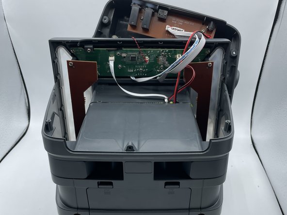

    • Use the opening tool or your hands to carefully pry open the now-loosened top panel.
    • The top portion of the shell is open, and the inside of the device is now accessible.

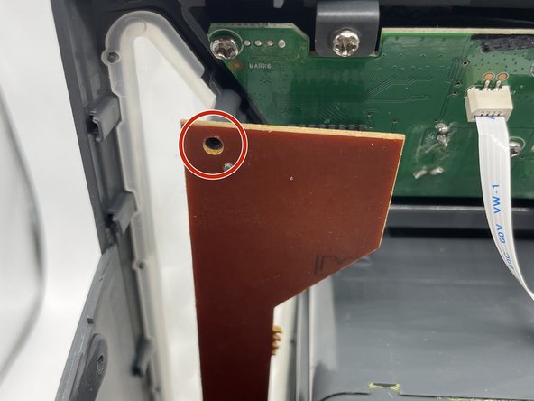

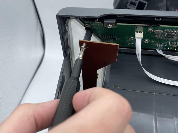

  4. Singing Machine Shine Duets LED Lights Replacement, LED Lights: crwdns2935265:04crwdnd2935265:01crwdnd2935265:03crwdne2935265:0 Singing Machine Shine Duets LED Lights Replacement, LED Lights: crwdns2935265:04crwdnd2935265:02crwdnd2935265:03crwdne2935265:0 Singing Machine Shine Duets LED Lights Replacement, LED Lights: crwdns2935265:04crwdnd2935265:03crwdnd2935265:03crwdne2935265:0
    • Remove the 10 mm screw from the LED lightboard using a Phillips #0 screwdriver.
  5. Singing Machine Shine Duets LED Lights Replacement: crwdns2935265:05crwdnd2935265:01crwdnd2935265:03crwdne2935265:0 Singing Machine Shine Duets LED Lights Replacement: crwdns2935265:05crwdnd2935265:02crwdnd2935265:03crwdne2935265:0 Singing Machine Shine Duets LED Lights Replacement: crwdns2935265:05crwdnd2935265:03crwdnd2935265:03crwdne2935265:0

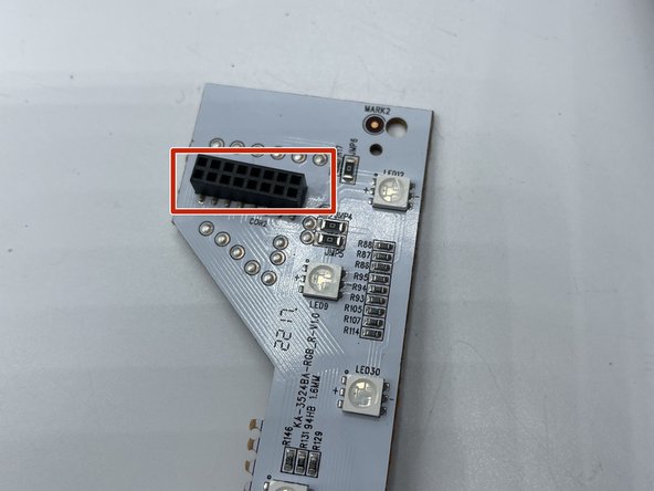

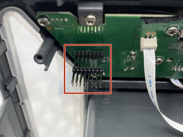

    • Carefully remove the lightboard from the device, taking care not to damage any pins.
    • To reassemble, connect the pins on the lightboard to the motherboard.
