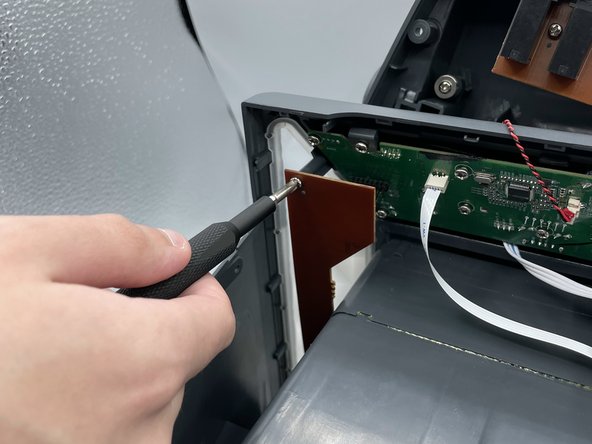

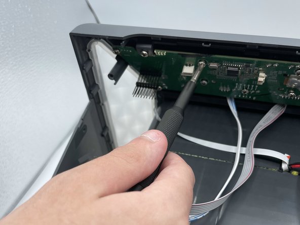

  5. Singing Machine Shine Duets Audio/Power Jack Replacement: crwdns2935265:05crwdnd2935265:01crwdnd2935265:02crwdne2935265:0 Singing Machine Shine Duets Audio/Power Jack Replacement: crwdns2935265:05crwdnd2935265:02crwdnd2935265:02crwdne2935265:0
    • Remove the two screws holding the LED board in place.

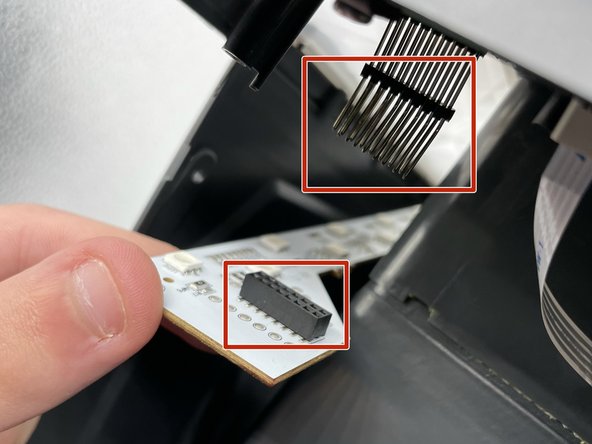

  6. Singing Machine Shine Duets Audio/Power Jack Replacement: crwdns2935265:06crwdnd2935265:01crwdnd2935265:02crwdne2935265:0 Singing Machine Shine Duets Audio/Power Jack Replacement: crwdns2935265:06crwdnd2935265:02crwdnd2935265:02crwdne2935265:0
    • Remove both LED boards from their pins.

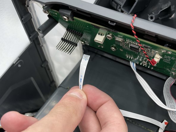

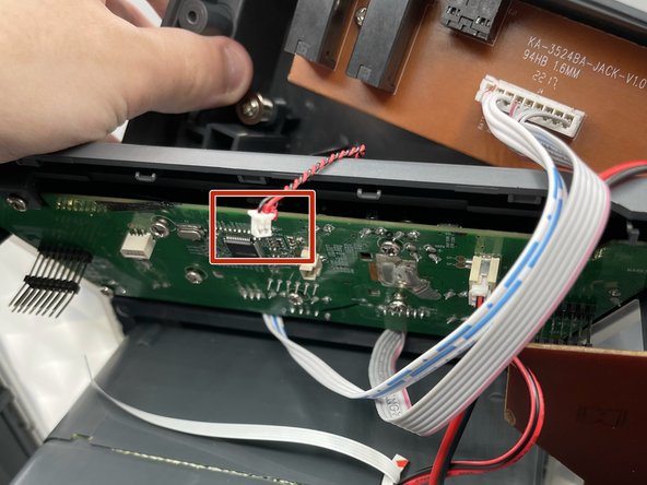

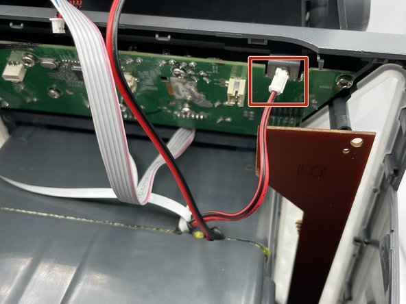

  7. Singing Machine Shine Duets Audio/Power Jack Replacement: crwdns2935265:07crwdnd2935265:01crwdnd2935265:02crwdne2935265:0 Singing Machine Shine Duets Audio/Power Jack Replacement: crwdns2935265:07crwdnd2935265:02crwdnd2935265:02crwdne2935265:0
    • Detach the white cable from its connector on the motherboard.
  8. Singing Machine Shine Duets Audio/Power Jack Replacement: crwdns2935265:08crwdnd2935265:01crwdnd2935265:02crwdne2935265:0 Singing Machine Shine Duets Audio/Power Jack Replacement: crwdns2935265:08crwdnd2935265:02crwdnd2935265:02crwdne2935265:0
    • Carefully disconnect this red-and-black wire from the motherboard.

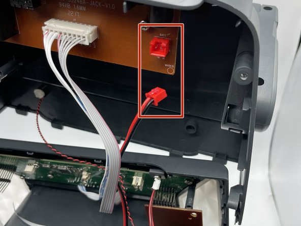

  9. Singing Machine Shine Duets Audio/Power Jack Replacement: crwdns2935265:09crwdnd2935265:01crwdnd2935265:02crwdne2935265:0 Singing Machine Shine Duets Audio/Power Jack Replacement: crwdns2935265:09crwdnd2935265:02crwdnd2935265:02crwdne2935265:0
    • Remove the thicker red-and-black wire from its socket on the motherboard.

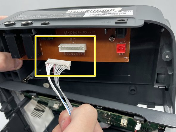

  10. Singing Machine Shine Duets Audio/Power Jack Replacement: crwdns2935265:010crwdnd2935265:01crwdnd2935265:03crwdne2935265:0 Singing Machine Shine Duets Audio/Power Jack Replacement: crwdns2935265:010crwdnd2935265:02crwdnd2935265:03crwdne2935265:0 Singing Machine Shine Duets Audio/Power Jack Replacement: crwdns2935265:010crwdnd2935265:03crwdnd2935265:03crwdne2935265:0
    • Disconnect the red port on the board which holds all of the external plugs
    • Disconnect the white wires from the board.

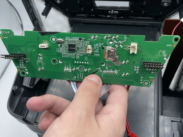

  11. Singing Machine Shine Duets Audio/Power Jack Replacement: crwdns2935265:011crwdnd2935265:01crwdnd2935265:02crwdne2935265:0 Singing Machine Shine Duets Audio/Power Jack Replacement: crwdns2935265:011crwdnd2935265:02crwdnd2935265:02crwdne2935265:0
    • Remove eleven 8 mm screws from the motherboard with a Phillips #0 screwdriver.

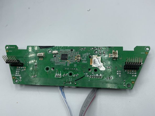

  12. Singing Machine Shine Duets Audio/Power Jack Replacement: crwdns2935265:012crwdnd2935265:01crwdnd2935265:03crwdne2935265:0 Singing Machine Shine Duets Audio/Power Jack Replacement: crwdns2935265:012crwdnd2935265:02crwdnd2935265:03crwdne2935265:0 Singing Machine Shine Duets Audio/Power Jack Replacement: crwdns2935265:012crwdnd2935265:03crwdnd2935265:03crwdne2935265:0
    • Remove the motherboard from the shell.

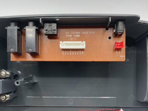

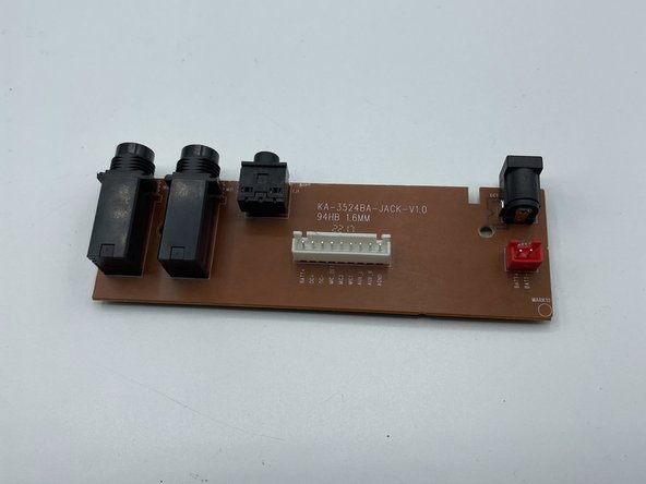

  13. Singing Machine Shine Duets Audio/Power Jack Replacement, Audio/Power Jack: crwdns2935265:013crwdnd2935265:01crwdnd2935265:02crwdne2935265:0 Singing Machine Shine Duets Audio/Power Jack Replacement, Audio/Power Jack: crwdns2935265:013crwdnd2935265:02crwdnd2935265:02crwdne2935265:0
    • Remove both screws from the board.
    • Use caution when removing the screw in between the two ports.
  14. Singing Machine Shine Duets Audio/Power Jack Replacement: crwdns2935265:014crwdnd2935265:01crwdnd2935265:02crwdne2935265:0 Singing Machine Shine Duets Audio/Power Jack Replacement: crwdns2935265:014crwdnd2935265:02crwdnd2935265:02crwdne2935265:0
    • Remove the board from the shell.
