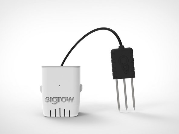

    • Watermelon Soil Sensor
    • b07 PCB [coated]
    • body b07
    • hat b07
    • inside bottom plate b07
    • You will need a flat-head screw driver (1.5 to 2.0 mm)

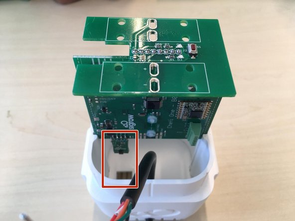

  2. Sigrow Soil Pro Assembly, Insertion cable: crwdns2935265:02crwdnd2935265:01crwdnd2935265:02crwdne2935265:0 Sigrow Soil Pro Assembly, Insertion cable: crwdns2935265:02crwdnd2935265:02crwdnd2935265:02crwdne2935265:0
    • Insert watermelon cable through case and inside bottom plate
    • Pay attention that the temperature humidity sensor slot is on the left side

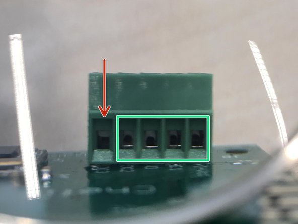

  3. Sigrow Soil Pro Assembly, Connect soil sensor to pcb: crwdns2935265:03crwdnd2935265:01crwdnd2935265:02crwdne2935265:0 Sigrow Soil Pro Assembly, Connect soil sensor to pcb: crwdns2935265:03crwdnd2935265:02crwdnd2935265:02crwdne2935265:0
    • Ensure all the ports of the connector are open
    • These 4 ports are open!
    • This port is closed!
    • To open the port unscrew counterclockwise
    • Follow the colour guideline and ensure all the cables are fully inserted.
    • Close the ports tightly by rotating clockwise. One at a time is easier.

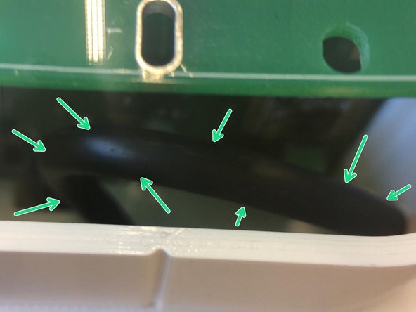

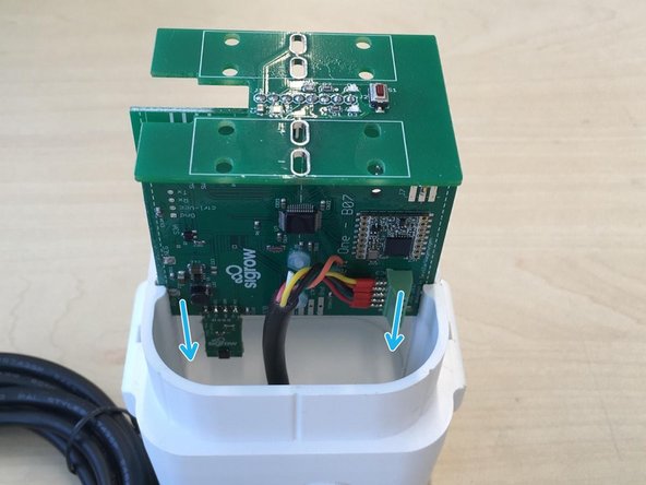

  4. Sigrow Soil Pro Assembly, Slide pcb in: crwdns2935265:04crwdnd2935265:01crwdnd2935265:03crwdne2935265:0 Sigrow Soil Pro Assembly, Slide pcb in: crwdns2935265:04crwdnd2935265:02crwdnd2935265:03crwdne2935265:0 Sigrow Soil Pro Assembly, Slide pcb in: crwdns2935265:04crwdnd2935265:03crwdnd2935265:03crwdne2935265:0
    • Ensure 8 to 12 cm of cable are left inside the case facing upwards
    • Slide pcb in.
    • Quality Control: If the PCB doesn't slide in the case or the fit is too loose (PCB slides downwards by itself when inverted) OR the pcb makes a shaki sound when you shake the case -> request new case or contact a senior sigrow technician
