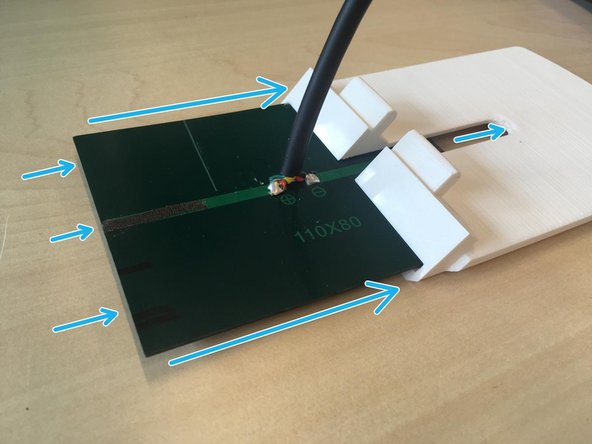

  2. Sigrow Soil Pro + Assembly, Prepare cable solar panel to PCB: crwdns2935265:02crwdnd2935265:01crwdnd2935265:03crwdne2935265:0 Sigrow Soil Pro + Assembly, Prepare cable solar panel to PCB: crwdns2935265:02crwdnd2935265:02crwdnd2935265:03crwdne2935265:0 Sigrow Soil Pro + Assembly, Prepare cable solar panel to PCB: crwdns2935265:02crwdnd2935265:03crwdnd2935265:03crwdne2935265:0
    • Cable length is aprox 20-22 cm
    • Peel both ends, keep the non-peeled part short
    • Group them, twist and solder them together
    • On the opposite side you will only keep two colours: black and yellow

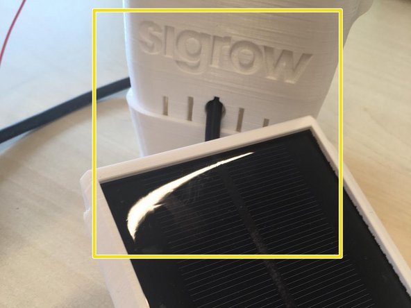

  3. Sigrow Soil Pro + Assembly, Solder cable solar panel: crwdns2935265:03crwdnd2935265:01crwdnd2935265:03crwdne2935265:0 Sigrow Soil Pro + Assembly, Solder cable solar panel: crwdns2935265:03crwdnd2935265:02crwdnd2935265:03crwdne2935265:0 Sigrow Soil Pro + Assembly, Solder cable solar panel: crwdns2935265:03crwdnd2935265:03crwdnd2935265:03crwdne2935265:0
    • Solder

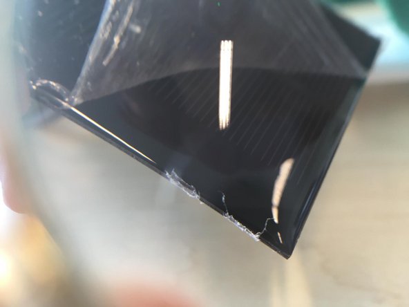

    • Remove the plastic sheet
    • Slide solar panel in parasol

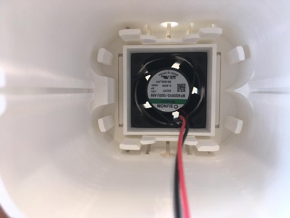

  4. Sigrow Soil Pro + Assembly, Fan mount: crwdns2935265:04crwdnd2935265:01crwdnd2935265:01crwdne2935265:0
    • Insert fan in fan holder
    • Pay attention to the fan air flow direction, it should be upwards

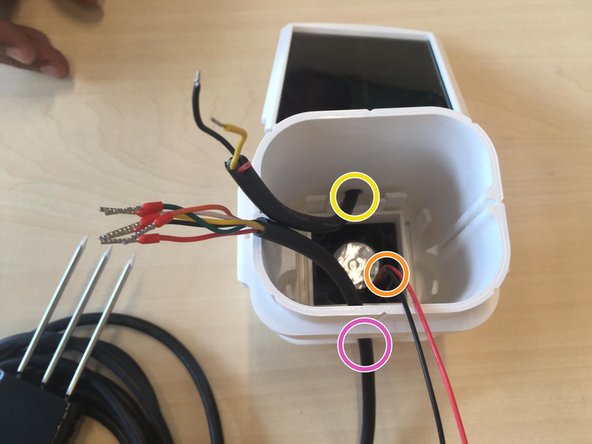

  5. Sigrow Soil Pro + Assembly, Peripherals: crwdns2935265:05crwdnd2935265:01crwdnd2935265:02crwdne2935265:0 Sigrow Soil Pro + Assembly, Peripherals: crwdns2935265:05crwdnd2935265:02crwdnd2935265:02crwdne2935265:0
    • From top to bottom:
    • Solar Panel mounted and with cable soldered (side with Sigrow letters)
    • Fan (cable enters from bottom)
    • Soil Sensor (cable enters from Sigrow 3 circles logo side)
  6. Sigrow Soil Pro + Assembly, Attach fan holder to main case+: crwdns2935265:06crwdnd2935265:01crwdnd2935265:02crwdne2935265:0 Sigrow Soil Pro + Assembly, Attach fan holder to main case+: crwdns2935265:06crwdnd2935265:02crwdnd2935265:02crwdne2935265:0

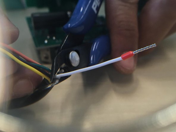

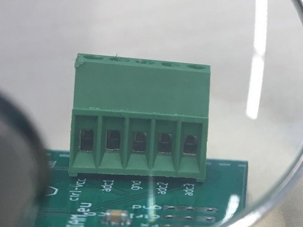

  9. Sigrow Soil Pro + Assembly, Soil Sensor connection: crwdns2935265:09crwdnd2935265:01crwdnd2935265:03crwdne2935265:0 Sigrow Soil Pro + Assembly, Soil Sensor connection: crwdns2935265:09crwdnd2935265:02crwdnd2935265:03crwdne2935265:0 Sigrow Soil Pro + Assembly, Soil Sensor connection: crwdns2935265:09crwdnd2935265:03crwdnd2935265:03crwdne2935265:0
    • Insert cables into connector, check in 3rd image in this step that the ports are open
    • Use pliers to cut white cable

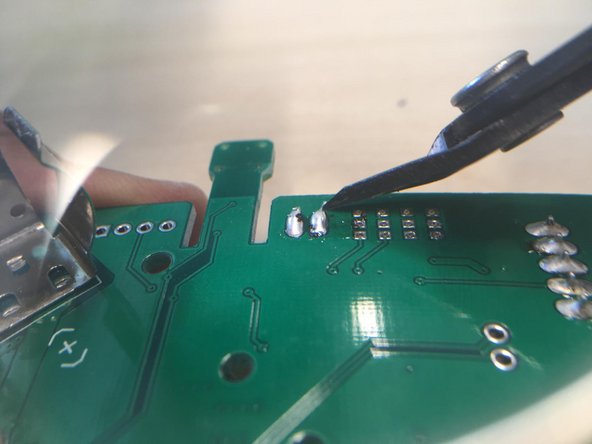

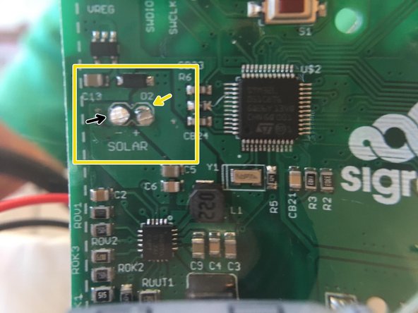

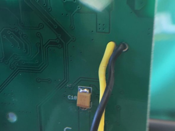

  11. Sigrow Soil Pro + Assembly, Solder solar panel cables to pcb: crwdns2935265:011crwdnd2935265:01crwdnd2935265:03crwdne2935265:0 Sigrow Soil Pro + Assembly, Solder solar panel cables to pcb: crwdns2935265:011crwdnd2935265:02crwdnd2935265:03crwdne2935265:0 Sigrow Soil Pro + Assembly, Solder solar panel cables to pcb: crwdns2935265:011crwdnd2935265:03crwdnd2935265:03crwdne2935265:0
    • Cables enter from the back of the PCB
    • Yellow is positive
    • Black is negative (closer to the edge)
    • Cut with pliers cable and tin excess

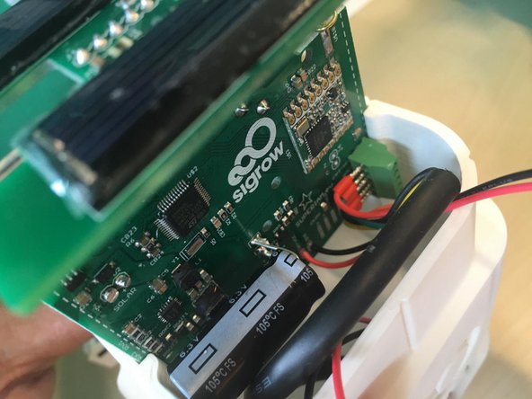

  12. Sigrow Soil Pro + Assembly, Insert PCB in case - Cable details: crwdns2935265:012crwdnd2935265:01crwdnd2935265:02crwdne2935265:0 Sigrow Soil Pro + Assembly, Insert PCB in case - Cable details: crwdns2935265:012crwdnd2935265:02crwdnd2935265:02crwdne2935265:0
    • It's great to leave some extra cables in good shape
    • ~10 cm for the soil sensor bended as inverted-U
    • Twist the fan cable (it's very long) and bend as inverted-U
    • if PCB doesn't slide down with a gentle push or slides out too easy when case is upside down new case should be requested.

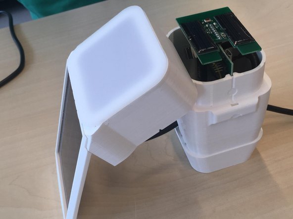

  13. Sigrow Soil Pro + Assembly, Closing the case: crwdns2935265:013crwdnd2935265:01crwdnd2935265:02crwdne2935265:0 Sigrow Soil Pro + Assembly, Closing the case: crwdns2935265:013crwdnd2935265:02crwdnd2935265:02crwdne2935265:0
    • After sliding PCB in, connect the solar parasol and the hat +
    • If the fit is not great inform Sigrow senior technician
