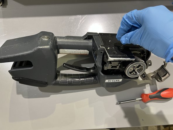

  1. Signode BXT3-16 Strapping Combo Tool Spring Replacement, Spring: crwdns2935265:01crwdnd2935265:01crwdnd2935265:01crwdne2935265:0
    • Before dismantling the strapping gun, ensure the power source / battery is removed.

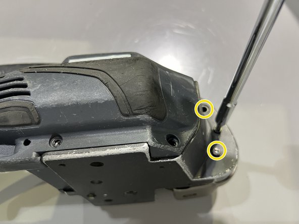

  2. Signode BXT3-16 Strapping Combo Tool Spring Replacement: crwdns2935265:02crwdnd2935265:01crwdnd2935265:01crwdne2935265:0
    • Turn the strapping gun upside down.
    • Place it on a flat surface to keep the strapping gun stable during repair.
    • There are four Torx T4 screws on the bottom of the tool.

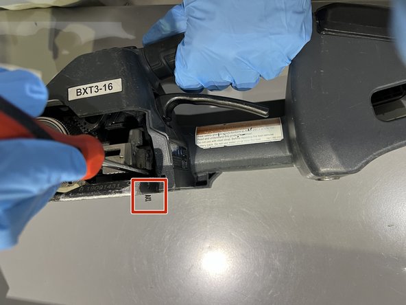

  3. Signode BXT3-16 Strapping Combo Tool Spring Replacement: crwdns2935265:03crwdnd2935265:01crwdnd2935265:03crwdne2935265:0 Signode BXT3-16 Strapping Combo Tool Spring Replacement: crwdns2935265:03crwdnd2935265:02crwdnd2935265:03crwdne2935265:0 Signode BXT3-16 Strapping Combo Tool Spring Replacement: crwdns2935265:03crwdnd2935265:03crwdnd2935265:03crwdne2935265:0
    • Use the Torx T4 screwdriver to remove the four 25 mm screws from the base plate.
    • Remove the single 25 mm Torx T4 screw from the front side of the strapping gun.
    • Use a Torx T4 screwdriver to remove the two 25 mm screws on the front of the tool.

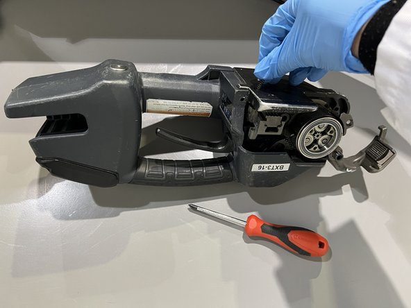

  4. Signode BXT3-16 Strapping Combo Tool Spring Replacement: crwdns2935265:04crwdnd2935265:01crwdnd2935265:01crwdne2935265:0
    • Rotate the strapping gun to the opposite side.
    • Use the Torx T4 screwdriver to remove the remaining 25 mm screws from the front of the strapping gun.

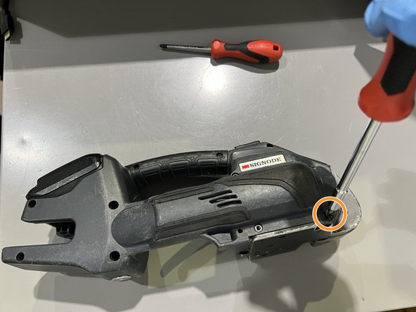

  5. Signode BXT3-16 Strapping Combo Tool Spring Replacement: crwdns2935265:05crwdnd2935265:01crwdnd2935265:02crwdne2935265:0 Signode BXT3-16 Strapping Combo Tool Spring Replacement: crwdns2935265:05crwdnd2935265:02crwdnd2935265:02crwdne2935265:0
    • Rotate the strapping tool to the original position, with the model number and name facing you.
    • Firmly pull the guard plate and the tool apart using both hands.

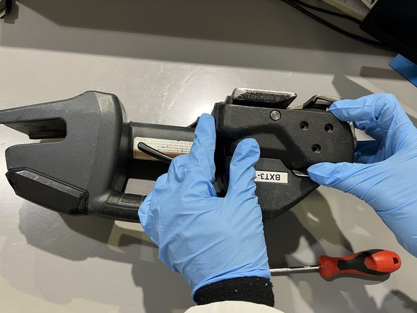

  6. Signode BXT3-16 Strapping Combo Tool Spring Replacement: crwdns2935265:06crwdnd2935265:01crwdnd2935265:02crwdne2935265:0 Signode BXT3-16 Strapping Combo Tool Spring Replacement: crwdns2935265:06crwdnd2935265:02crwdnd2935265:02crwdne2935265:0
    • Use a metal spudger to lift the cutter.
    • Gently, push the spring out from the bottom of the base of the strapping gun.
  7. Signode BXT3-16 Strapping Combo Tool Spring Replacement: crwdns2935265:07crwdnd2935265:01crwdnd2935265:03crwdne2935265:0 Signode BXT3-16 Strapping Combo Tool Spring Replacement: crwdns2935265:07crwdnd2935265:02crwdnd2935265:03crwdne2935265:0 Signode BXT3-16 Strapping Combo Tool Spring Replacement: crwdns2935265:07crwdnd2935265:03crwdnd2935265:03crwdne2935265:0
    • Rotate the machine to remove the spring gently by hand.
    • Remove the spring from the base of the strapping tool.
    • Replace with new spring by inserting it the same way it was removed.
