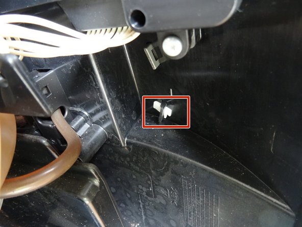

  7. Siemens Surpresso TK56001 coffee spout distributor replacement, Coffee Spout distributor: crwdns2935265:07crwdnd2935265:01crwdnd2935265:02crwdne2935265:0 Siemens Surpresso TK56001 coffee spout distributor replacement, Coffee Spout distributor: crwdns2935265:07crwdnd2935265:02crwdnd2935265:02crwdne2935265:0
    • The semicircular decorative strip around the panel above the coffee spout is held from the inside on the left and right by two small white plastic wedges. Use your fingers to pull them out.

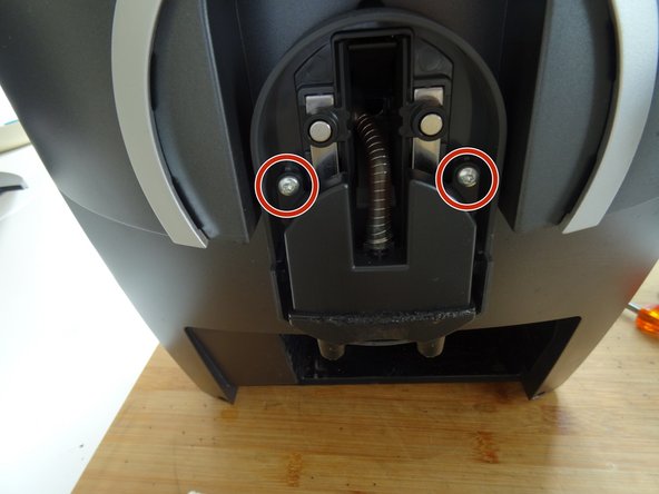

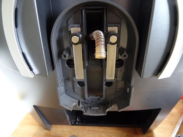

  9. Siemens Surpresso TK56001 coffee spout distributor replacement: crwdns2935265:09crwdnd2935265:01crwdnd2935265:03crwdne2935265:0 Siemens Surpresso TK56001 coffee spout distributor replacement: crwdns2935265:09crwdnd2935265:02crwdnd2935265:03crwdne2935265:0 Siemens Surpresso TK56001 coffee spout distributor replacement: crwdns2935265:09crwdnd2935265:03crwdnd2935265:03crwdne2935265:0
    • The housing around the coffee spout distributor consists of two halves. The front part is locked on the left and right.
    • Insert a plastic opening tool into the gap on the side and separate the two halves of the case. The clips are pretty tight.
    • Remove the two Torx T10 screws on the coffee spout distributor.
    • Disconnect the silicone tube at the top of the coffee spout distributor. Pay attention to the wire spiral.
    • Remove the coffee spout distributor.
