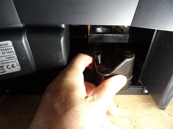

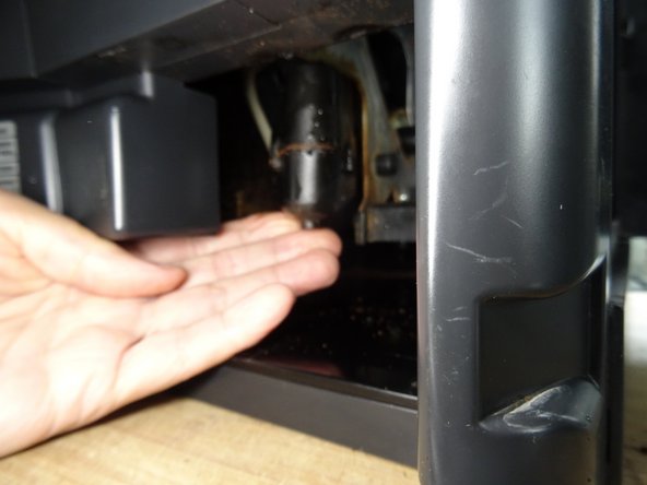

    • Loosen the three rubber caps on the brew group.
    • Using a strong flat-blade screwdriver, adjust the three plastic slots underneath so that the "unlocked" position is indicated.
    • Note: with the newer version of the brew group, only one lever needs to be flipped.
    • Pull out the brew group. If it is stuck, pull firmly and evenly, but with feeling, preferably at the bottom right.

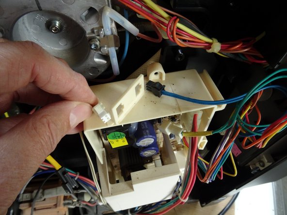

    • In order to access the drain valve, you must first loosen some cables, as well as the electronics box and the supply hose.
    • Remove the two Torx T10 screws at the top and bottom of the electronics box.
    • Pull the box out a little.
  8. Siemens Surpresso - Bosch Benvenuto revise drain valve: crwdns2935265:08crwdnd2935265:01crwdnd2935265:03crwdne2935265:0 Siemens Surpresso - Bosch Benvenuto revise drain valve: crwdns2935265:08crwdnd2935265:02crwdnd2935265:03crwdne2935265:0 Siemens Surpresso - Bosch Benvenuto revise drain valve: crwdns2935265:08crwdnd2935265:03crwdnd2935265:03crwdne2935265:0
    • Two connectors are attached to the top. First press in the release on both connectors and pull the connectors out.
    • Press in the catches on the side of the two sockets and pull the sockets out of the electronics box.
    • No other cables need to be disconnected, lay the box on its side.

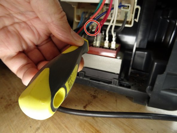

    • Remove the Torx T20 screw of the green/yellow grounding cable on the flow heater.
    • Push the green/yellow grounding cable to the side.
    • Pull off the two flat connectors with the yellow cables on the microswitch of the gearbox.

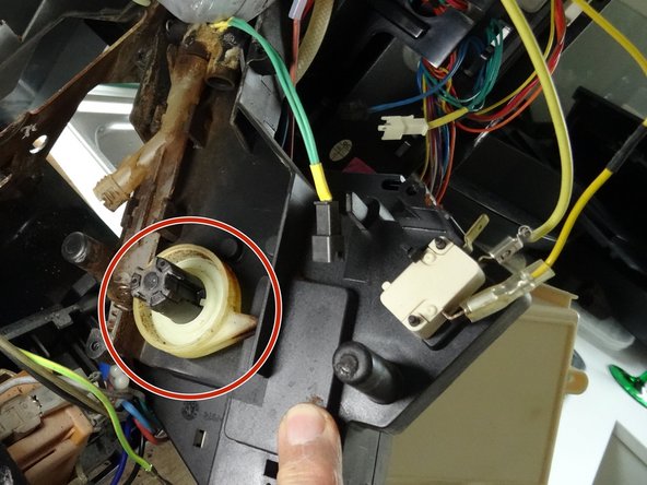

    • Reach into the machine from the front and find the triangular expansion tank. Turn it counterclockwise about 60° and pull it off downward
  11. Siemens Surpresso - Bosch Benvenuto revise drain valve: crwdns2935265:011crwdnd2935265:01crwdnd2935265:02crwdne2935265:0 Siemens Surpresso - Bosch Benvenuto revise drain valve: crwdns2935265:011crwdnd2935265:02crwdnd2935265:02crwdne2935265:0
    • Turn the machine around again.
    • Now you can pull out the gearbox as far as possible. It is a bit tricky and you have to be very careful. Turn it so that you can already see the drain valve.
    • The drain valve is still connected to the water hose. Pull out the clamp on the water hose with a small screwdriver. This is really tedious and of course when reassembling. But with patience it works.
    • Then pull out the pressure hose. At its end is an O-ring it gets stuck either on the end or in the connector. Replace it - if possible - during reassembly.

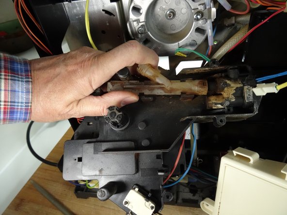

    • Now the gearbox can be carefully lifted out and the drain valve becomes visible.
    • Lift out the white driver. Pay attention to the correct orientation when reassembling.

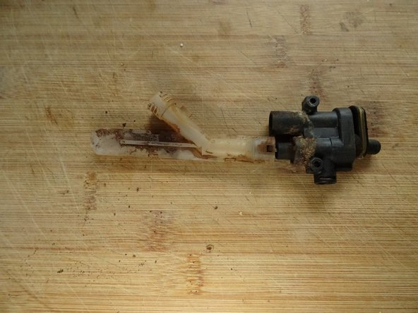

  14. Siemens Surpresso - Bosch Benvenuto revise drain valve: crwdns2935265:014crwdnd2935265:01crwdnd2935265:03crwdne2935265:0 Siemens Surpresso - Bosch Benvenuto revise drain valve: crwdns2935265:014crwdnd2935265:02crwdnd2935265:03crwdne2935265:0 Siemens Surpresso - Bosch Benvenuto revise drain valve: crwdns2935265:014crwdnd2935265:03crwdnd2935265:03crwdne2935265:0
    • The drain valve is free.
    • Note: this is the older version, but the newer one fits just as well.

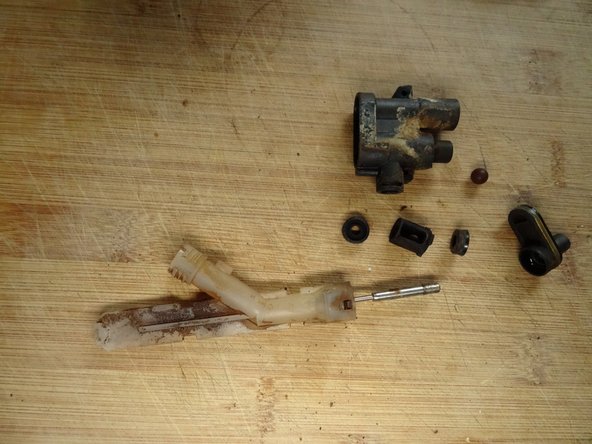

    • The third picture shows the older version in disassembled condition. You can now replace the seals or the whole valve....
  15. Siemens Surpresso - Bosch Benvenuto revise drain valve, Drainage valve gaskets: crwdns2935265:015crwdnd2935265:01crwdnd2935265:01crwdne2935265:0
    • There are different versions of this valve. The tappet can be different, the valve stem can only be a ball, one or two seals are used. However, all valves function in the same way.
    • Pull the cap of the grey upper valve body. Use pliers, if it is stuck.
    • There are two gaskets, the flat side pointing outwards.
    • Newer valves have only one gasket
    • Plunger and downholder
    • Piston and spring
    • Replace the gaskets and reassemble the valve.
