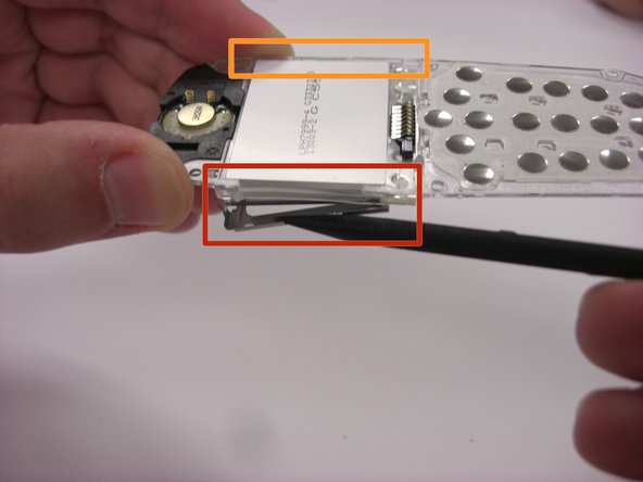

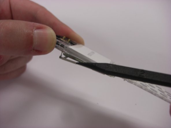

    1. Siemens A56 LCD Display Replacement, LCD Display: crwdns2935265:08crwdnd2935265:01crwdnd2935265:03crwdne2935265:0 Siemens A56 LCD Display Replacement, LCD Display: crwdns2935265:08crwdnd2935265:02crwdnd2935265:03crwdne2935265:0 Siemens A56 LCD Display Replacement, LCD Display: crwdns2935265:08crwdnd2935265:03crwdnd2935265:03crwdne2935265:0
      • Locate the LCD Display.
      • Above the display, there are two metal clasps. Bend the clasps until they are straight.
    2. Siemens A56 LCD Display Replacement: crwdns2935265:09crwdnd2935265:01crwdnd2935265:03crwdne2935265:0 Siemens A56 LCD Display Replacement: crwdns2935265:09crwdnd2935265:02crwdnd2935265:03crwdne2935265:0 Siemens A56 LCD Display Replacement: crwdns2935265:09crwdnd2935265:03crwdnd2935265:03crwdne2935265:0
      • On the sides of the display there are two more metal clasps.
      • Gently bend the clasp so that the metal display frame becomes loose from the screen.
      • Flip the device over and gently bend the other clasp so that the metal display frame becomes loose from the screen.

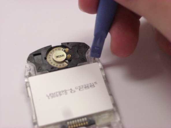

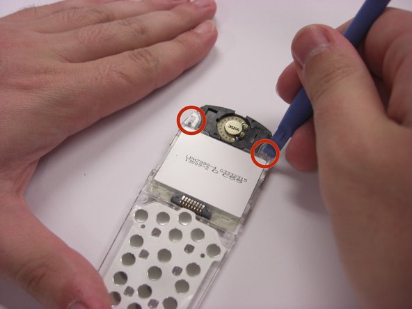

    3. Siemens A56 LCD Display Replacement: crwdns2935265:010crwdnd2935265:01crwdnd2935265:03crwdne2935265:0 Siemens A56 LCD Display Replacement: crwdns2935265:010crwdnd2935265:02crwdnd2935265:03crwdne2935265:0 Siemens A56 LCD Display Replacement: crwdns2935265:010crwdnd2935265:03crwdnd2935265:03crwdne2935265:0
      • Place the device so the display screen is facing up.
      • On the bottom of the display frame, locate two plastic rivets.
      • Remove these rivets by scraping with the plastic opening tool or a fingernail.
      • Once removed, the plastic rivets can only be reapplied with a heat gun.

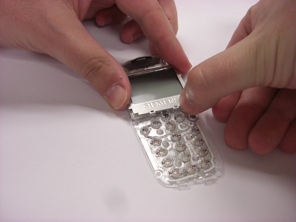

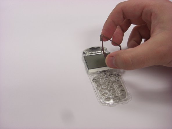

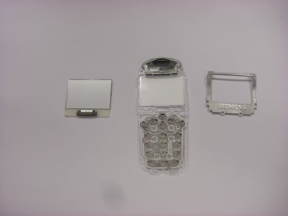

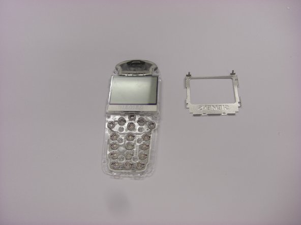

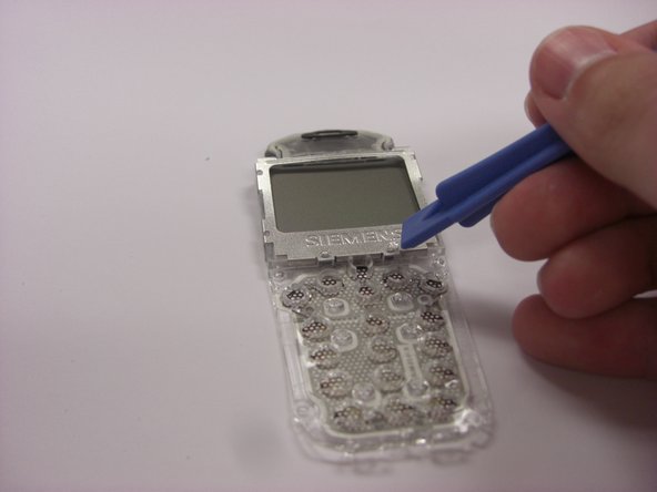

    4. Siemens A56 LCD Display Replacement: crwdns2935265:011crwdnd2935265:01crwdnd2935265:03crwdne2935265:0 Siemens A56 LCD Display Replacement: crwdns2935265:011crwdnd2935265:02crwdnd2935265:03crwdne2935265:0 Siemens A56 LCD Display Replacement: crwdns2935265:011crwdnd2935265:03crwdnd2935265:03crwdne2935265:0
      • To remove the metal frame, gently grab the frame and lift from the keypad interface.
      • If the frame cannot be easily removed. ensure that the metal clasps from steps 8 and 9 have been sufficiently bent to allow removal.

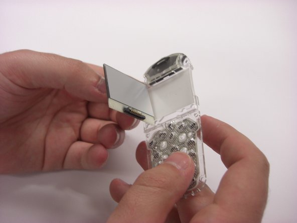

    5. Siemens A56 LCD Display Replacement: crwdns2935265:012crwdnd2935265:01crwdnd2935265:03crwdne2935265:0 Siemens A56 LCD Display Replacement: crwdns2935265:012crwdnd2935265:02crwdnd2935265:03crwdne2935265:0 Siemens A56 LCD Display Replacement: crwdns2935265:012crwdnd2935265:03crwdnd2935265:03crwdne2935265:0
      • Once the metal frame is removed, the LCD display should fall from the keypad interface when tilted.
