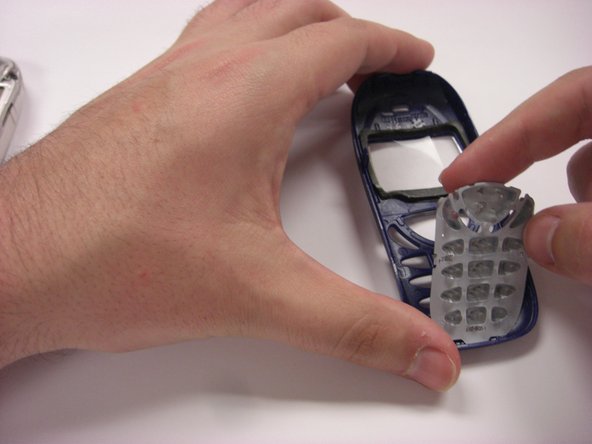

    1. Siemens A56 Keyboard Replacement, Front Plate: crwdns2935265:03crwdnd2935265:01crwdnd2935265:03crwdne2935265:0 Siemens A56 Keyboard Replacement, Front Plate: crwdns2935265:03crwdnd2935265:02crwdnd2935265:03crwdne2935265:0 Siemens A56 Keyboard Replacement, Front Plate: crwdns2935265:03crwdnd2935265:03crwdnd2935265:03crwdne2935265:0
      • Firmly grasp the white casing of the phone with one hand and the blue cover with the other hand as seen in the first picture.
      • Pull up on the two plastic clips at the top of the phone.
      • While the clips are pulled up, pull the blue cover away from the white casing to remove it.

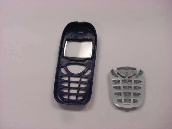

    1. Siemens A56 Keyboard Replacement, Keyboard: crwdns2935265:04crwdnd2935265:01crwdnd2935265:03crwdne2935265:0 Siemens A56 Keyboard Replacement, Keyboard: crwdns2935265:04crwdnd2935265:02crwdnd2935265:03crwdne2935265:0 Siemens A56 Keyboard Replacement, Keyboard: crwdns2935265:04crwdnd2935265:03crwdnd2935265:03crwdne2935265:0
      • The keyboard can be easily removed by hand.
      • Once the old keyboard has been removed, it is possible to replace it with a new keyboard.
