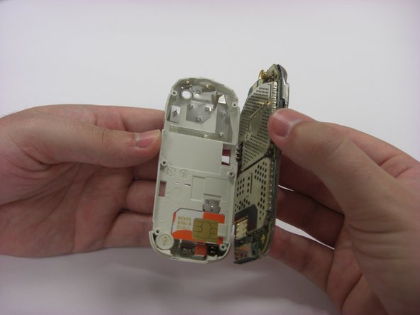

  5. Siemens A56 Back Plastic Cover Replacement: crwdns2935265:05crwdnd2935265:01crwdnd2935265:03crwdne2935265:0 Siemens A56 Back Plastic Cover Replacement: crwdns2935265:05crwdnd2935265:02crwdnd2935265:03crwdne2935265:0 Siemens A56 Back Plastic Cover Replacement: crwdns2935265:05crwdnd2935265:03crwdnd2935265:03crwdne2935265:0
    • To remove the back plastic cover, grasp the device with both hands as seen in the first picture.
    • Gently remove the motherboard from the back plastic cover.
    • The motherboard is fragile, so proper care is necessary when handling and storing in order to prevent damage.
