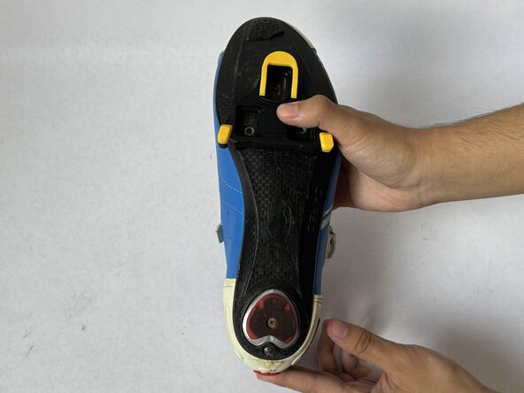

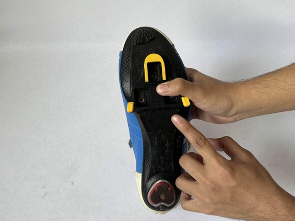

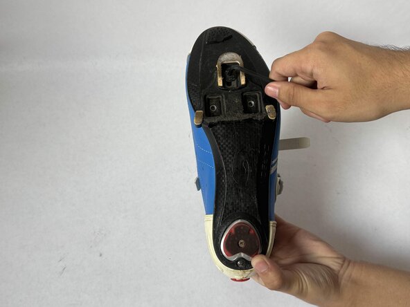

    • Flip the shoe over so the bottom is facing up.
    • Use a 3 mm hex wrench to remove the screws from the cleats.
    • Keep the screws in case you need them for the new cleats.

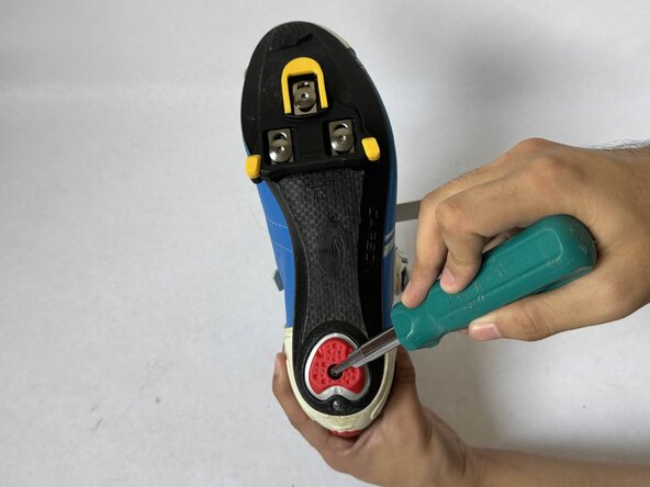

  2. Sidi Bike Shoe Cleat and Heel Plate Replacement: crwdns2935265:02crwdnd2935265:01crwdnd2935265:03crwdne2935265:0 Sidi Bike Shoe Cleat and Heel Plate Replacement: crwdns2935265:02crwdnd2935265:02crwdnd2935265:03crwdne2935265:0 Sidi Bike Shoe Cleat and Heel Plate Replacement: crwdns2935265:02crwdnd2935265:03crwdnd2935265:03crwdne2935265:0
    • Remove the old cleat and align the new one
    • After the screws are undone, you can remove the old cleat by pulling it away from the shoe.
    • Align the new cleat with the holes where the screws are supposed to be and hold it firmly.

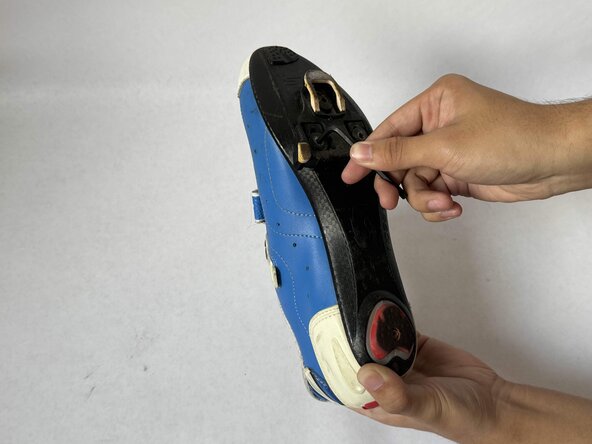

  3. Sidi Bike Shoe Cleat and Heel Plate Replacement: crwdns2935265:03crwdnd2935265:01crwdnd2935265:02crwdne2935265:0 Sidi Bike Shoe Cleat and Heel Plate Replacement: crwdns2935265:03crwdnd2935265:02crwdnd2935265:02crwdne2935265:0
    • Securing the new cleat
    • Insert all screws and lightly screw in and test the cleat for comfort. Once testing is done, tighten the screw until the cleat does not move.
    • (Warning - Do not over-tighten the screw as you risk damaging the threads of the screw)

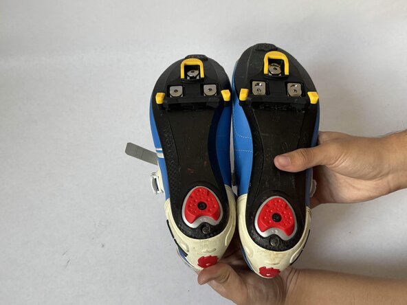

  4. Sidi Bike Shoe Cleat and Heel Plate Replacement: crwdns2935265:04crwdnd2935265:01crwdnd2935265:02crwdne2935265:0 Sidi Bike Shoe Cleat and Heel Plate Replacement: crwdns2935265:04crwdnd2935265:02crwdnd2935265:02crwdne2935265:0
    • Taking off the old heel plate
    • Unscrew the heel plate with a Phillips #1 screwdriver, apply firm pressure, and turn the screwdriver counterclockwise.

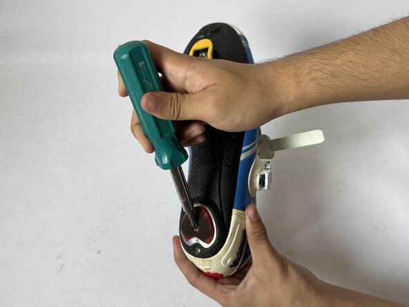

  5. Sidi Bike Shoe Cleat and Heel Plate Replacement: crwdns2935265:05crwdnd2935265:01crwdnd2935265:02crwdne2935265:0 Sidi Bike Shoe Cleat and Heel Plate Replacement: crwdns2935265:05crwdnd2935265:02crwdnd2935265:02crwdne2935265:0
    • Removing the old heel plate
    • Remove the old heel plate by unscrewing the screw and pulling the plate away from the shoe.
    • Place the new one, aligning it with the hole for the screw, holding it in place.

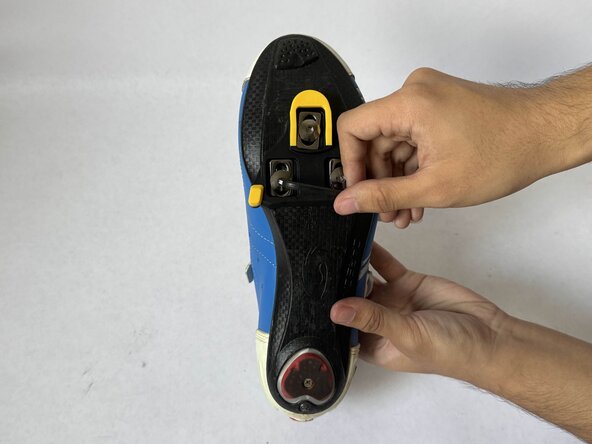

  6. Sidi Bike Shoe Cleat and Heel Plate Replacement: crwdns2935265:06crwdnd2935265:01crwdnd2935265:01crwdne2935265:0
    • Securing the heel plate
    • Insert the screw and use the screwdriver to secure the heel plate. Screw until the heel plate does not move.
    • (Warning - do not over-tighten the screw as you risk damaging the thread)
  7. Sidi Bike Shoe Cleat and Heel Plate Replacement: crwdns2935265:07crwdnd2935265:01crwdnd2935265:02crwdne2935265:0 Sidi Bike Shoe Cleat and Heel Plate Replacement: crwdns2935265:07crwdnd2935265:02crwdnd2935265:02crwdne2935265:0
    • Done! Make sure to put on your shoe and test for comfort, and repeat each step for the other shoe.
