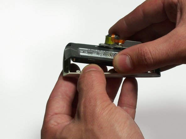

  4. Sidekick II Teardown: crwdns2935265:04crwdnd2935265:01crwdnd2935265:01crwdne2935265:0
    • Flip the screen up halfway (90 degrees), to reveal the 2 screws above the right side of the keyboard.
    • Use the Torx 6 screwdriver to remove these 2 screws.
    • Be careful in handling the phone after removing the screws, because the two main bodies of the phone are no longer attached.

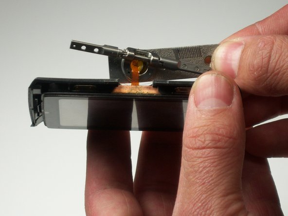

  6. Sidekick II Teardown, Sidekick II Teardown: crwdns2935265:06crwdnd2935265:01crwdnd2935265:02crwdne2935265:0 Sidekick II Teardown, Sidekick II Teardown: crwdns2935265:06crwdnd2935265:02crwdnd2935265:02crwdne2935265:0
    • Remove screen from casing.
  7. Sidekick II Teardown: crwdns2935265:07crwdnd2935265:01crwdnd2935265:02crwdne2935265:0 Sidekick II Teardown: crwdns2935265:07crwdnd2935265:02crwdnd2935265:02crwdne2935265:0
    • Remove 4 screws from back of screen using Torx 6 Screwdriver.
    • Pry screen out of casing using fingers.

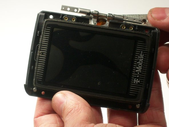

  8. Sidekick II Teardown: crwdns2935265:08crwdnd2935265:01crwdnd2935265:03crwdne2935265:0 Sidekick II Teardown: crwdns2935265:08crwdnd2935265:02crwdnd2935265:03crwdne2935265:0 Sidekick II Teardown: crwdns2935265:08crwdnd2935265:03crwdnd2935265:03crwdne2935265:0
    • Remove 4 screws from front of screen with Phillip screwdrivers.
    • Peel off the metal covering on the back of the screen.
    • Be careful when taking off the metal covering. The orange ribbon will not come out all the way, and it is fragile.
  9. Sidekick II Teardown: crwdns2935265:09crwdnd2935265:01crwdnd2935265:01crwdne2935265:0
    • Remove the protective cover in front of the screen.
    • Do not use metal tools, you may damage the protective cover or the screen. Use your fingers only.
  10. Sidekick II Teardown: crwdns2935265:010crwdnd2935265:01crwdnd2935265:02crwdne2935265:0 Sidekick II Teardown: crwdns2935265:010crwdnd2935265:02crwdnd2935265:02crwdne2935265:0
    • Take the screws out using the Torx 6 screwdriver.
    • Then lift the thumb wheel and housing off of the front panel.

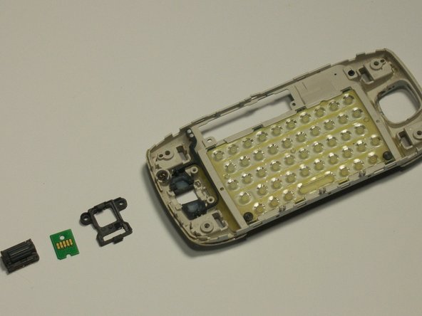

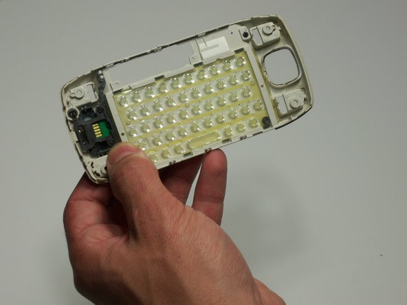

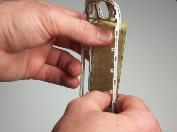

  11. Sidekick II Teardown: crwdns2935265:011crwdnd2935265:01crwdnd2935265:02crwdne2935265:0 Sidekick II Teardown: crwdns2935265:011crwdnd2935265:02crwdnd2935265:02crwdne2935265:0
    • Remove 2 black "rivets" from back of casing with the plastic opening tool.
    • Press keyboard out of front of casing using thumbs. Don't press too hard as you may break the board.
  12. Sidekick II Teardown: crwdns2935265:012crwdnd2935265:01crwdnd2935265:02crwdne2935265:0 Sidekick II Teardown: crwdns2935265:012crwdnd2935265:02crwdnd2935265:02crwdne2935265:0

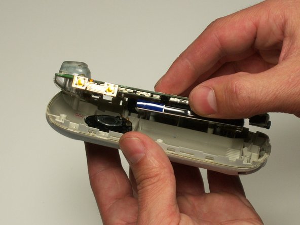

    • Remove the 5 black screws with a Phillips head screwdriver.
    • Lift the bottom of the control board from housing, and separate the two.
  13. Sidekick II Teardown: crwdns2935265:013crwdnd2935265:01crwdnd2935265:01crwdne2935265:0
    • Carefully remove battery and back plate.
    • Do not use metal tools, you may damage the control board. Use only your fingers.
