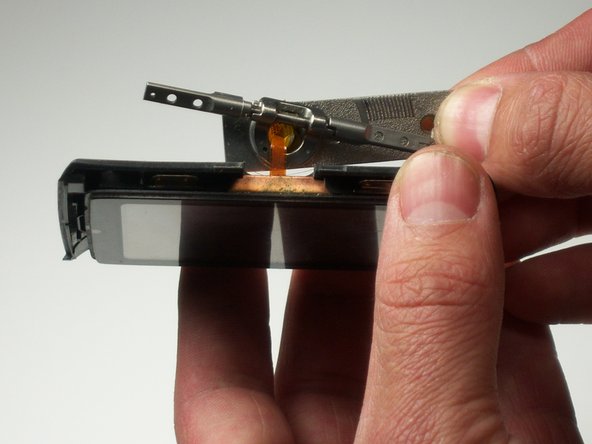

  8. Sidekick II LCD Screen Replacement: crwdns2935265:08crwdnd2935265:01crwdnd2935265:01crwdne2935265:0
    • Separate screen from housing with your fingers.

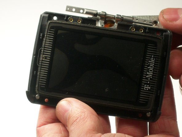

  9. Sidekick II LCD Screen Replacement: crwdns2935265:09crwdnd2935265:01crwdnd2935265:03crwdne2935265:0 Sidekick II LCD Screen Replacement: crwdns2935265:09crwdnd2935265:02crwdnd2935265:03crwdne2935265:0 Sidekick II LCD Screen Replacement: crwdns2935265:09crwdnd2935265:03crwdnd2935265:03crwdne2935265:0
    • Remove 4 screws
    • Pay attention to the orientation of the screen on the backing because it is difficult to reassemble.
  10. Sidekick II LCD Screen Replacement: crwdns2935265:010crwdnd2935265:01crwdnd2935265:01crwdne2935265:0
    • Remove LCD protective cover with your fingers.
