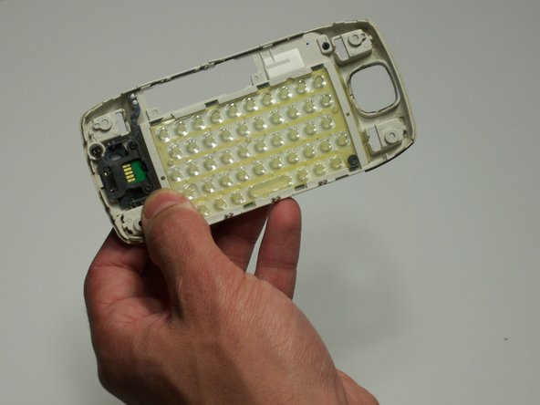

  6. Sidekick II Keyboard Replacement, Keyboard: crwdns2935265:06crwdnd2935265:01crwdnd2935265:02crwdne2935265:0 Sidekick II Keyboard Replacement, Keyboard: crwdns2935265:06crwdnd2935265:02crwdnd2935265:02crwdne2935265:0
    • Remove screen from case
  7. Sidekick II Keyboard Replacement: crwdns2935265:07crwdnd2935265:01crwdnd2935265:01crwdne2935265:0
    • Remove both black "rivets" from the back of the case with the plastic opening tool.
  8. Sidekick II Keyboard Replacement: crwdns2935265:08crwdnd2935265:01crwdnd2935265:01crwdne2935265:0
    • Push keyboard out of the front of the casing with your thumbs.
    • Make sure not to press too hard; you may break the board.
