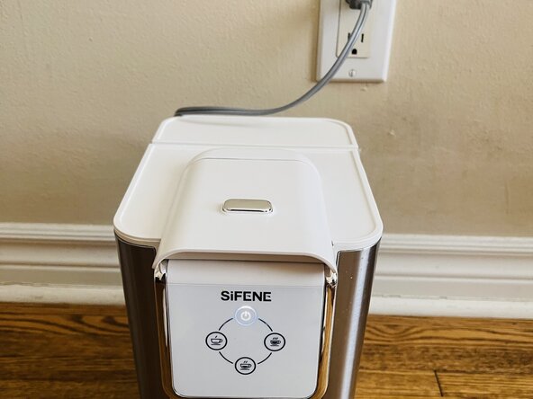

    • Disconnect the coffee machine from the power outlet.
    • Wait for the machine to cool completely before beginning disassembly.

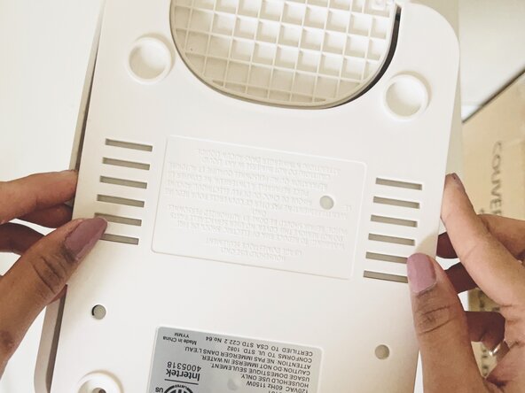

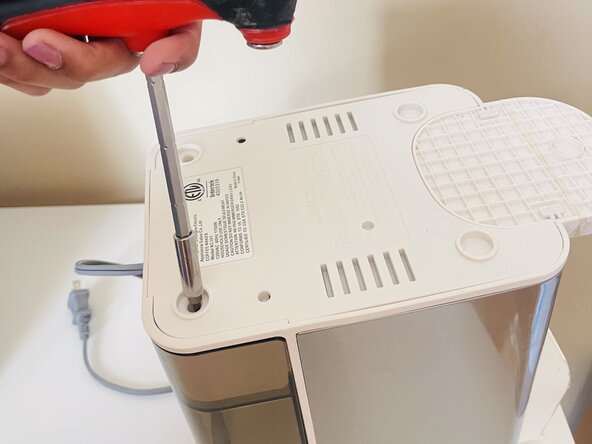

    • Use a Phillips #1 screwdriver to remove the two 10 mm screws securing the bottom cover.
    • Carefully lift the bottom cover up and off.
    • Perform the repair in a dry, well-lit environment to ensure safety and visibility.

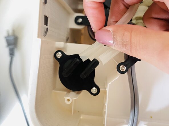

  3. SiFENE KC101 Nozzle Assembly Replacement: crwdns2935265:03crwdnd2935265:01crwdnd2935265:02crwdne2935265:0 SiFENE KC101 Nozzle Assembly Replacement: crwdns2935265:03crwdnd2935265:02crwdnd2935265:02crwdne2935265:0

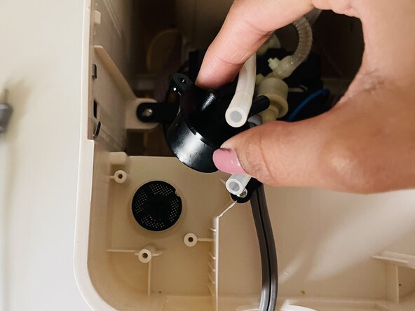

    • Identify the nozzle assembly connecting the water tank to the pump. It is a plastic component with tubing attached, situated to the left of the power cord. ​
    • Gently disconnect the tubing connected to the nozzle assembly. Take care not to damage the tubing.​
    • Mark the tubes with tape or labels to ensure accurate reassembly.
  4. SiFENE KC101 Nozzle Assembly Replacement: crwdns2935265:04crwdnd2935265:01crwdnd2935265:02crwdne2935265:0 SiFENE KC101 Nozzle Assembly Replacement: crwdns2935265:04crwdnd2935265:02crwdnd2935265:02crwdne2935265:0
    • Remove the two 8 mm Phillips screws securing the nozzle assembly.
    • Carefully remove the nozzle assembly.
    • If you encounter resistance when removing components, double-check for any missed screws or clips.

  6. SiFENE KC101 Nozzle Assembly Replacement: crwdns2935265:06crwdnd2935265:01crwdnd2935265:02crwdne2935265:0 SiFENE KC101 Nozzle Assembly Replacement: crwdns2935265:06crwdnd2935265:02crwdnd2935265:02crwdne2935265:0
    • Attach the tubing to the new nozzle assembly, ensuring a snug fit to prevent leaks.

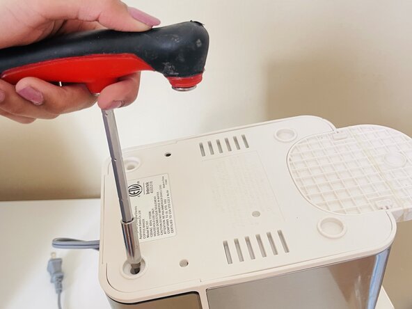

    • Place the top cover back onto the machine.
    • Secure it with the two 10 mm Phillips screws.
    • Ensure all screws are tightened securely but avoid over-tightening to prevent damage.

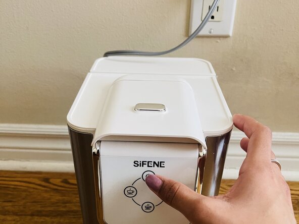

    • Plug the machine back into the power source.
    • Run a test brew cycle with water to ensure there are no leaks and that the machine is functioning correctly.
