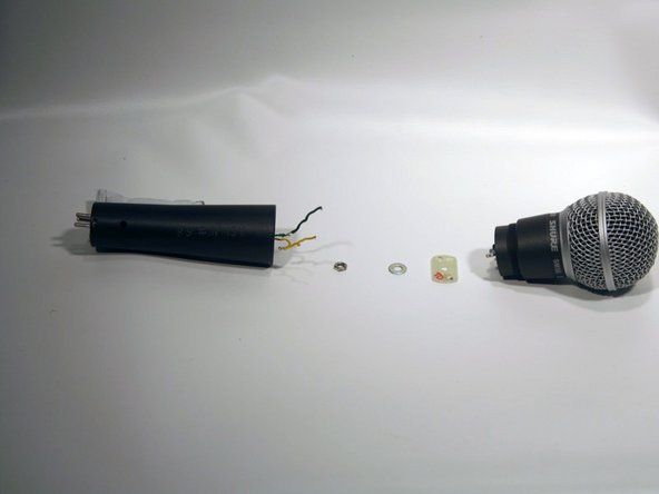

    • Remove the yellow and green wires from the face plate.
    • Note which side the yellow and green wires connect to.
  2. Shure SM58 Faceplate Replacement: crwdns2935265:02crwdnd2935265:01crwdnd2935265:02crwdne2935265:0 Shure SM58 Faceplate Replacement: crwdns2935265:02crwdnd2935265:02crwdnd2935265:02crwdne2935265:0
    • Never open the microphone capsule. Attempting to open the capsule will likely result in permanent damage and make the microphone unusable.
    • Using an adjustable crescent wrench, remove the nut and washer from the face plate by twisting the nut counterclockwise.
  3. Shure SM58 Faceplate Replacement: crwdns2935265:03crwdnd2935265:01crwdnd2935265:02crwdne2935265:0 Shure SM58 Faceplate Replacement: crwdns2935265:03crwdnd2935265:02crwdnd2935265:02crwdne2935265:0
    • Slide the face plate over the connector.
Follow the steps of the guide in reverse to reassemble the microphone. In order to solder wires back to faceplate use soldering guide.
