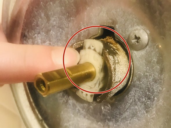

  5. Shower Valve Cartridge Replacement: crwdns2935265:05crwdnd2935265:01crwdnd2935265:03crwdne2935265:0 Shower Valve Cartridge Replacement: crwdns2935265:05crwdnd2935265:02crwdnd2935265:03crwdne2935265:0 Shower Valve Cartridge Replacement: crwdns2935265:05crwdnd2935265:03crwdnd2935265:03crwdne2935265:0
    • Remove the clip (looks similar to a cotter pin) by pulling it straight up; may use a flathead screwdriver to assist with removing it, but be careful not to lose any parts.
    • Ensure that you annotate which side the Hot and Cold belong; there is an “H/C” marking on the cartridge cover; ensure that when you replace it with the new cartridge that it’s facing the same way as the old cartridge.
  6. Shower Valve Cartridge Replacement: crwdns2935265:06crwdnd2935265:01crwdnd2935265:03crwdne2935265:0 Shower Valve Cartridge Replacement: crwdns2935265:06crwdnd2935265:02crwdnd2935265:03crwdne2935265:0 Shower Valve Cartridge Replacement: crwdns2935265:06crwdnd2935265:03crwdnd2935265:03crwdne2935265:0
    • Use the Posi-Temp Puller to remove the cartridge from the shower; you’ll need to screw it in place, then manually pull the cartridge out of the shower socket using a slow/controlled slightly twisting movement.

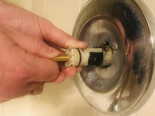

  7. Shower Valve Cartridge Replacement: crwdns2935265:07crwdnd2935265:01crwdnd2935265:03crwdne2935265:0 Shower Valve Cartridge Replacement: crwdns2935265:07crwdnd2935265:02crwdnd2935265:03crwdne2935265:0 Shower Valve Cartridge Replacement: crwdns2935265:07crwdnd2935265:03crwdnd2935265:03crwdne2935265:0
    • Once the valve comes out, you may experience some water coming from the shower socket opening; inspect the socket opening for any debris (rubber, slime, etc) that might be left behind after removing the cartridge.
  8. Shower Valve Cartridge Replacement: crwdns2935265:08crwdnd2935265:01crwdnd2935265:03crwdne2935265:0 Shower Valve Cartridge Replacement: crwdns2935265:08crwdnd2935265:02crwdnd2935265:03crwdne2935265:0 Shower Valve Cartridge Replacement: crwdns2935265:08crwdnd2935265:03crwdnd2935265:03crwdne2935265:0
    • Now take the new cartridge and start pushing the cartridge cover where “H/C” is annotated into the socket opening with the “H/C” oriented as the previous cartridge.
    • If the cartridge does not go all the way in to the same stop location, use the tool that came with the new cartridge to assist with pushing it in on the cover; this will ensure that you do not damage the new cartridge during installation.
