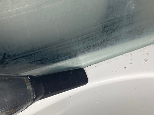

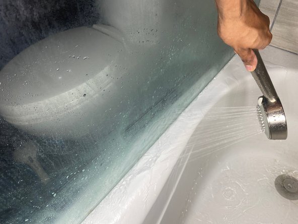

      • Make sure the area is dry and clean.

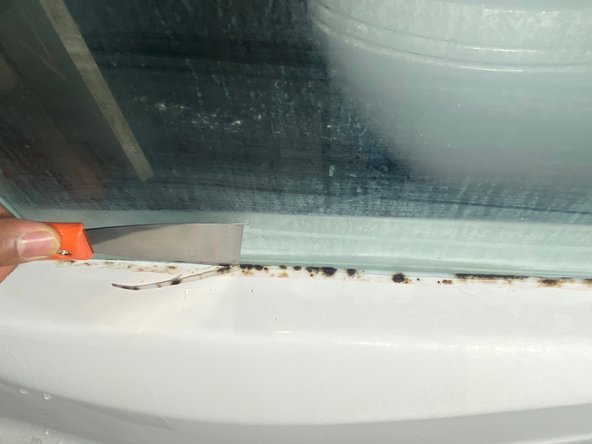

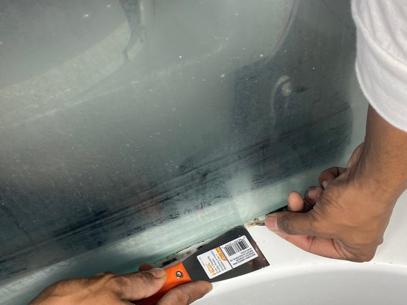

      • Use a putty knife to separate the silicone from the bathtub and from the glass sides.
      • Pull the old silicone with your hand while using the putty knife to separate the silicone.

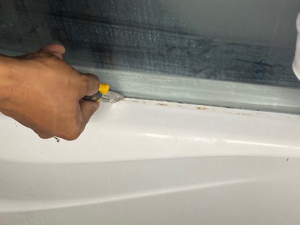

      • Use a utility knife to remove any large sticking mold or silicone parts still left.
      • Use a fine grit sand paper to take off the small parts of the old silicone.
      • Vacuum away all the debris.
      • Be very precise and take your time with the knife.

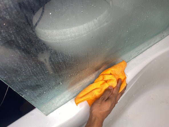

      • Clean the area with a mold cleaner so that small matter, and particles can be removed. Spray the cleaner, wait about 15 minutes, scrub, and wash thoroughly until all the chemical is gone.
      • Wear gloves if using cleaner that has bleach or strong chemicals.
      • Now wipe the area clean with a microfiber cloth, until it is dry.

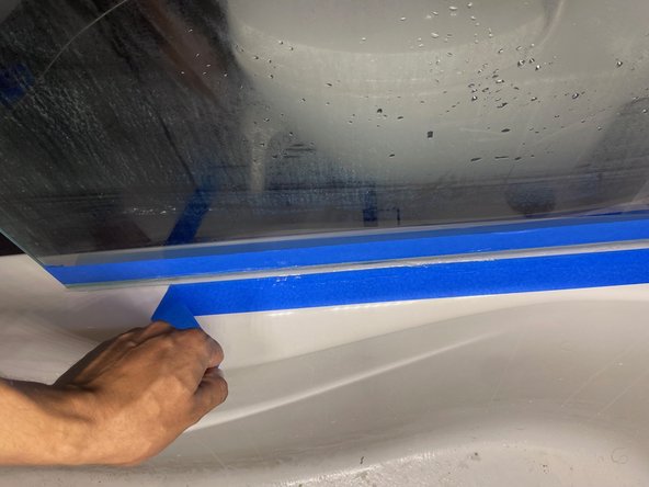

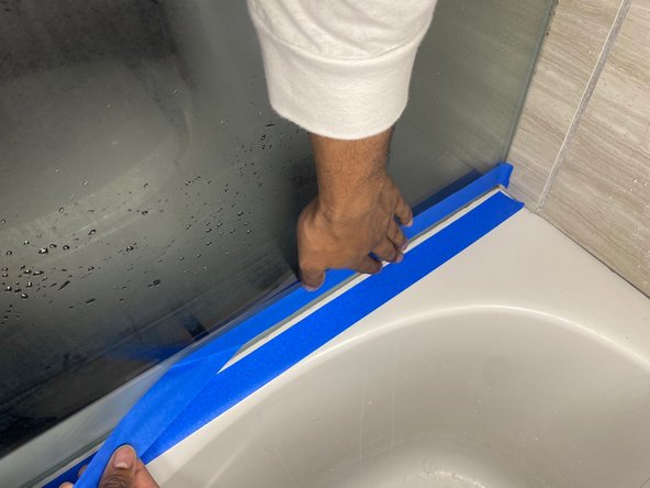

      • Wait until the area is completely dry, which may also done by continuously wiping with a dry cloth.
      • Use painters tape to mask off both ends of the joint, at about a centimeter above and to the side of the tub.

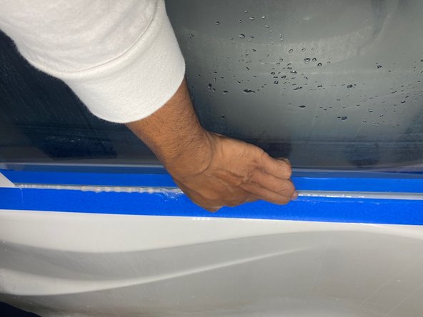

      • Place the new tube of silicone in the gun, and cut off about a half inch off of the tip. Poke the hole from the tip of the new silicone, with the accessory on the caulking gun.
      • Press slowly until the glue comes out slightly. Start from one end and press into the crack as you run the silicone to the other end in one motion. Use an amount of glue so that it comes out slightly at the corners that you're caulking.
      • Make sure to put enough glue and not too little, as you will need to run your finger down the glue in one motion to smooth it out. Run your finger only once.
      • Wait about 10 minutes and remove the tape, so that the glue doesn't fully dry with the tape. The finish will also look cleaner when you remove the tape after caulking.
