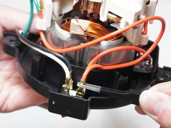

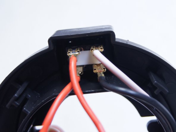

  5. Shop-Vac MC150A Motor Replacement, Disconnect the switch: crwdns2935265:05crwdnd2935265:01crwdnd2935265:03crwdne2935265:0 Shop-Vac MC150A Motor Replacement, Disconnect the switch: crwdns2935265:05crwdnd2935265:02crwdnd2935265:03crwdne2935265:0 Shop-Vac MC150A Motor Replacement, Disconnect the switch: crwdns2935265:05crwdnd2935265:03crwdnd2935265:03crwdne2935265:0
    • Pull out and disconnect the four spade connectors from the switch module.
    • During reassembly, use the last image as a reference for how to connect the wires.

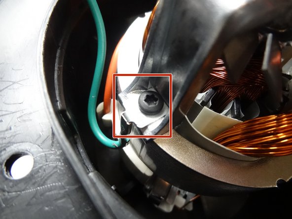

  6. Shop-Vac MC150A Motor Replacement, Unscrew the motor bracket: crwdns2935265:06crwdnd2935265:01crwdnd2935265:02crwdne2935265:0 Shop-Vac MC150A Motor Replacement, Unscrew the motor bracket: crwdns2935265:06crwdnd2935265:02crwdnd2935265:02crwdne2935265:0
    • Use a Torx T15 driver to unscrew the two screws securing the metal motor bracket.
  7. Shop-Vac MC150A Motor Replacement: crwdns2935265:07crwdnd2935265:01crwdnd2935265:02crwdne2935265:0 Shop-Vac MC150A Motor Replacement: crwdns2935265:07crwdnd2935265:02crwdnd2935265:02crwdne2935265:0
    • During reassembly, be sure to reattach the green ground wire clip to the bracket.
