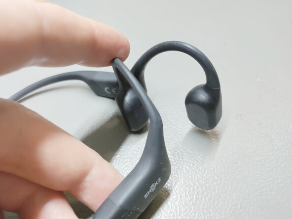

  1. Shokz OpenRun Snapped headphone frame repair, Inspection: crwdns2935265:01crwdnd2935265:01crwdnd2935265:01crwdne2935265:0
    • The headphones were working fine electrically, but one side of the frame was broken. Because these are bone conduction headphones, they need the frame to press the speaker against your skull.

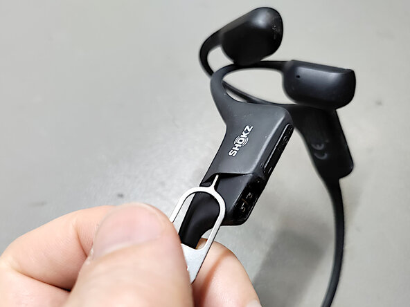

  2. Shokz OpenRun Snapped headphone frame repair, Removing the silicone cover: crwdns2935265:02crwdnd2935265:01crwdnd2935265:03crwdne2935265:0 Shokz OpenRun Snapped headphone frame repair, Removing the silicone cover: crwdns2935265:02crwdnd2935265:02crwdnd2935265:03crwdne2935265:0 Shokz OpenRun Snapped headphone frame repair, Removing the silicone cover: crwdns2935265:02crwdnd2935265:03crwdnd2935265:03crwdne2935265:0
    • Pull back the silicone cover, starting from the wide end. Best tool for this is a SIM card ejector, because it is narrow but without sharp edges. Avoid tearing the silicone, though it is not the end of the world if that happens.
    • There is a thin layer of adhesive underneath the silicone. First go all around the perimeter releasing the adhesive, then pull back a bit and repeat.
    • A thin sliver of silicone goes between and under the volume buttons. You'll need to cut the silicone a bit as the buttons are not detachable.
    • Be careful when you get close to the snapped area. Avoid accidentally pulling on the thin wires.
  3. Shokz OpenRun Snapped headphone frame repair, Identify broken part: crwdns2935265:03crwdnd2935265:01crwdnd2935265:01crwdne2935265:0
    • For me, the frame snapped right where the spring steel wire exits the plastic its end is embedded into.
    • The plastic part can be removed by taking out a small metal staple. Press from the opposite side to push it out, then pull with pliers.
