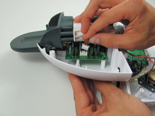

  3. Sharper Image iPulse SI325 Speakers Replacement: crwdns2935265:03crwdnd2935265:01crwdnd2935265:02crwdne2935265:0 Sharper Image iPulse SI325 Speakers Replacement: crwdns2935265:03crwdnd2935265:02crwdnd2935265:02crwdne2935265:0
    • Grip both sides of the top round part of the case and carefully open it like a clam. The bottom of the two halves are connected by the speaker wire. Do not separate by more than 1 centimeter.
    • Grip either side of the top round part of the case and carefully open the device to reveal all the hidden treasures inside!
    • Lay the device down, so that all the internal components are facing upwards.

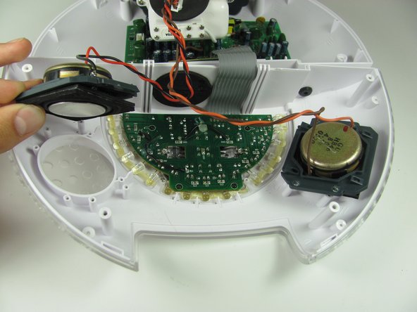

  4. Sharper Image iPulse SI325 Speakers Replacement, Speakers: crwdns2935265:04crwdnd2935265:01crwdnd2935265:02crwdne2935265:0 Sharper Image iPulse SI325 Speakers Replacement, Speakers: crwdns2935265:04crwdnd2935265:02crwdnd2935265:02crwdne2935265:0
    • Disconnect the speaker wire from the motherboard by firmly griping the black and red wires close to the connection with two fingers and pulling the connector out.
    • Wiggling the connector back and forth as you pull will make removal easier.
  5. Sharper Image iPulse SI325 Speakers Replacement: crwdns2935265:05crwdnd2935265:01crwdnd2935265:02crwdne2935265:0 Sharper Image iPulse SI325 Speakers Replacement: crwdns2935265:05crwdnd2935265:02crwdnd2935265:02crwdne2935265:0
    • Remove the eight 11mm Phillips #1 screws that connect the speakers to the white outer case.
