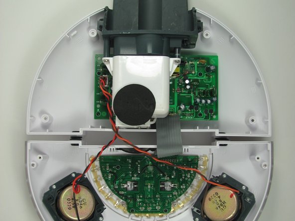

    • Gently position the device so that the buttons and speakers lie face down.
    • Unplug the power cord from the "DC Input."
  2. Sharper Image iPulse SI325 Outer Case Replacement: crwdns2935265:02crwdnd2935265:01crwdnd2935265:03crwdne2935265:0 Sharper Image iPulse SI325 Outer Case Replacement: crwdns2935265:02crwdnd2935265:02crwdnd2935265:03crwdne2935265:0 Sharper Image iPulse SI325 Outer Case Replacement: crwdns2935265:02crwdnd2935265:03crwdnd2935265:03crwdne2935265:0
    • Remove the four 12mm phillips head #2 screws located along the outer edge of the white case.
    • Be careful! There are two small, easily-broken, plastic tabs at the bottom of the device keeping it together.
    • Once you remove the screws, pick the device up so that the grey label on the bottom of the device faces toward you.
    • With your thumbs on either side of the grey label, slowly push with both thumbs until the case pops open.
    • A small gap will open as the two tabs are released.
    • Do not pull the two halves apart yet. They are held together by the speaker wire.
  3. Sharper Image iPulse SI325 Outer Case Replacement: crwdns2935265:03crwdnd2935265:01crwdnd2935265:02crwdne2935265:0 Sharper Image iPulse SI325 Outer Case Replacement: crwdns2935265:03crwdnd2935265:02crwdnd2935265:02crwdne2935265:0
    • Grip both sides of the top round part of the case and carefully open it like a clam. The bottom of the two halves are connected by the speaker wire. Do not separate by more than 1 centimeter.
    • Grip either side of the top round part of the case and carefully open the device to reveal all the hidden treasures inside!
    • Lay the device down, so that all the internal components are facing upwards.
