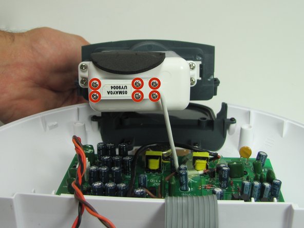

  4. Sharper Image iPulse SI325 Motherboard Replacement, Motherboard: crwdns2935265:04crwdnd2935265:01crwdnd2935265:01crwdne2935265:0
    • Turn the device over so that the internals are facing down.
    • Remove the three 7mm Phillips #1 screws connecting the Zipconnect unit.
  5. Sharper Image iPulse SI325 Motherboard Replacement: crwdns2935265:05crwdnd2935265:01crwdnd2935265:02crwdne2935265:0 Sharper Image iPulse SI325 Motherboard Replacement: crwdns2935265:05crwdnd2935265:02crwdnd2935265:02crwdne2935265:0
    • Turn the device over again so you are looking at the internals.
    • The Zipconnect unit will lift out but will still be attached by a wire connected to the motherboard.
    • Remove the six 7mm Phillips #1 phillips screws attatching the Zipconnect unit to the motherboard wire and set the unit out of the way.

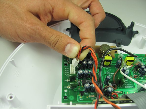

  6. Sharper Image iPulse SI325 Motherboard Replacement: crwdns2935265:06crwdnd2935265:01crwdnd2935265:02crwdne2935265:0 Sharper Image iPulse SI325 Motherboard Replacement: crwdns2935265:06crwdnd2935265:02crwdnd2935265:02crwdne2935265:0
    • Disconnect the speaker wire from the motherboard by firmly griping the wires close to the connection with two fingers and pull the connector out.
    • Wiggling the connector back and forth as you pull will make removal easier.

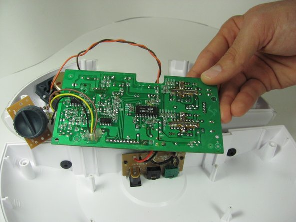

  7. Sharper Image iPulse SI325 Motherboard Replacement: crwdns2935265:07crwdnd2935265:01crwdnd2935265:01crwdne2935265:0
    • Remove the two 11mm Phillips #1 screws attaching the small brown circuit board to the plastic outer case.
    • Also remove the four 11mm Phillips #1 screws attaching the motherboard to the plastic case.
  8. Sharper Image iPulse SI325 Motherboard Replacement: crwdns2935265:08crwdnd2935265:01crwdnd2935265:03crwdne2935265:0 Sharper Image iPulse SI325 Motherboard Replacement: crwdns2935265:08crwdnd2935265:02crwdnd2935265:03crwdne2935265:0 Sharper Image iPulse SI325 Motherboard Replacement: crwdns2935265:08crwdnd2935265:03crwdnd2935265:03crwdne2935265:0

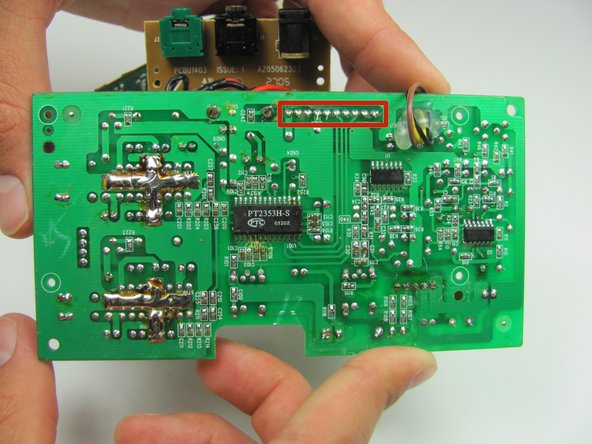

    • Lift up on both the motherboard and brown circuit board which contains the light intensity dial.
    • Turn over the motherboard and remove the solder connecting the wide, flat, grey wire.
