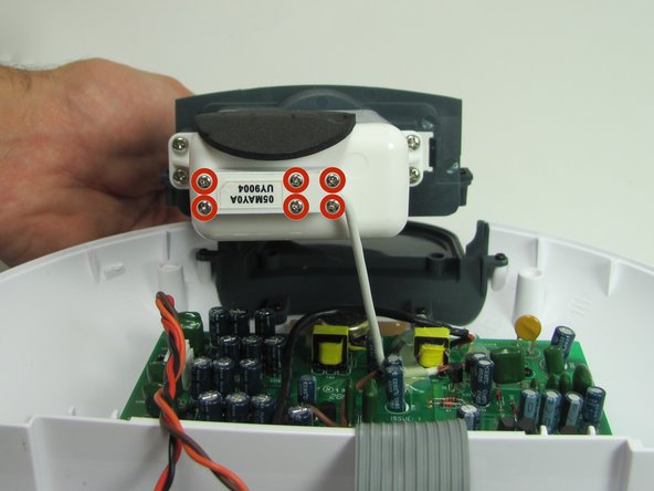

    • Turn the device over again so you are looking at the internals.
    • The Zipconnect unit will lift out but will still be attached by a wire connected to the motherboard.
    • Remove the six 7mm Phillips #1 screws attatching the Zipconnect unit to the motherboard wire and set the unit out of the way.

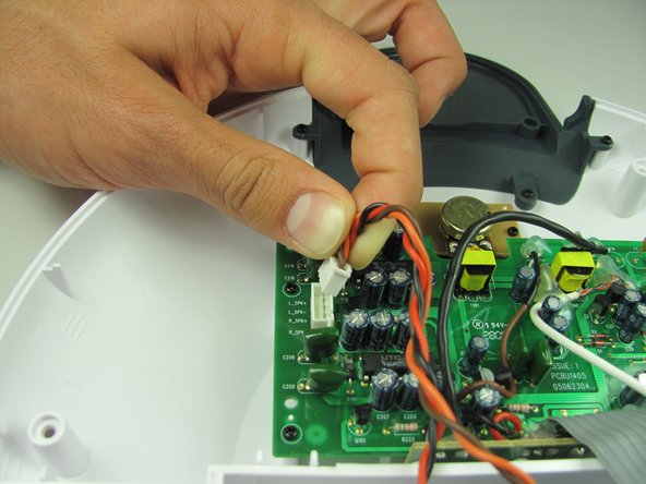

  6. Sharper Image iPulse SI325 Light Intensity Dial Replacement: crwdns2935265:06crwdnd2935265:01crwdnd2935265:02crwdne2935265:0 Sharper Image iPulse SI325 Light Intensity Dial Replacement: crwdns2935265:06crwdnd2935265:02crwdnd2935265:02crwdne2935265:0
    • Next, disconnect the speaker wire from the motherboard by firmly griping the wires as close to the connection with two fingers as possible and pulling the connector out.
    • Moving the connector back and forth as you pull will make removal easier.

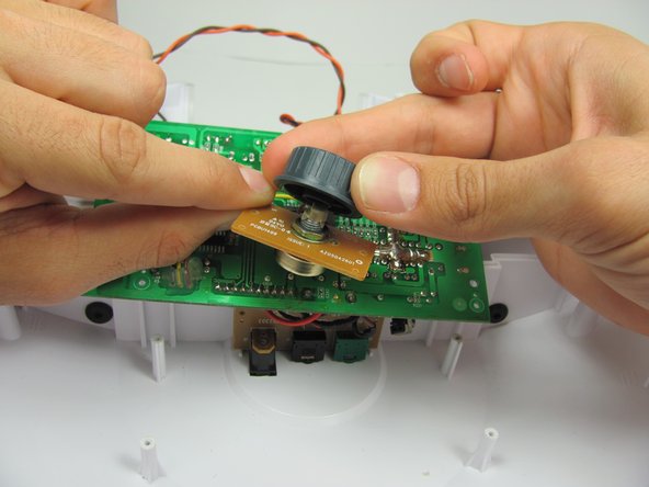

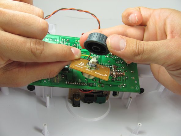

    • Lift up on both the motherboard and brown circuit board that contains the light intensity dial and turn the motherboard over.
  9. Sharper Image iPulse SI325 Light Intensity Dial Replacement: crwdns2935265:09crwdnd2935265:01crwdnd2935265:03crwdne2935265:0 Sharper Image iPulse SI325 Light Intensity Dial Replacement: crwdns2935265:09crwdnd2935265:02crwdnd2935265:03crwdne2935265:0 Sharper Image iPulse SI325 Light Intensity Dial Replacement: crwdns2935265:09crwdnd2935265:03crwdnd2935265:03crwdne2935265:0
    • Hold the brown circuit board with one hand and the light intensity dial with two fingers of your other hand and carefully pull them apart.
