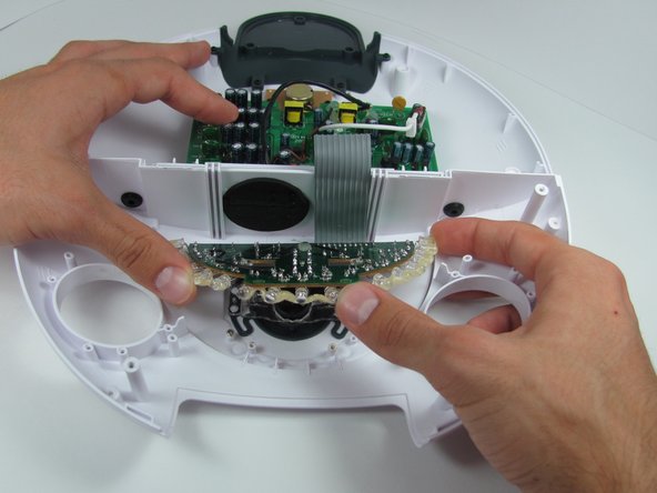

    • Remove the four 7mm Phillips #1 screws on the circuit board with the LED lights.
    • Slowly lift the circuit board out of the front cover and place the cover out of the way.

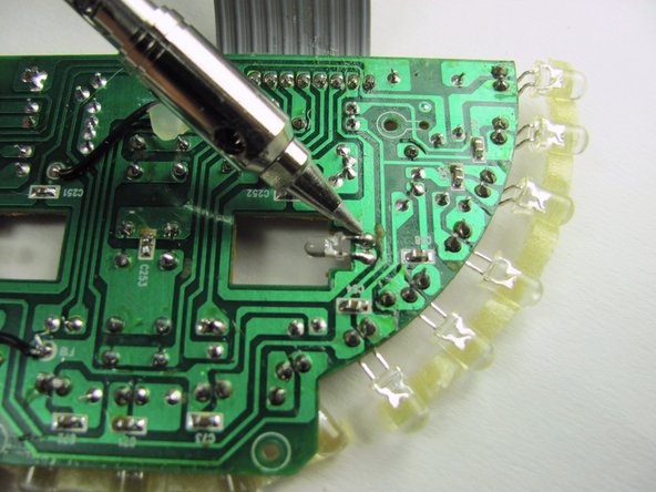

    • Remove the solder connecting the LED light that needs replacement.
