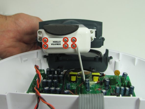

  4. Sharper Image iPulse SI325 DC Input Replacement, Auxiliary Input: crwdns2935265:04crwdnd2935265:01crwdnd2935265:01crwdne2935265:0
    • Turn the device over so that the internals are facing down; the Light Intensity Dial will be facing you.
    • Remove the three 7mm Phillips #1 screws connecting the Zipconnect unit.
  5. Sharper Image iPulse SI325 DC Input Replacement: crwdns2935265:05crwdnd2935265:01crwdnd2935265:02crwdne2935265:0 Sharper Image iPulse SI325 DC Input Replacement: crwdns2935265:05crwdnd2935265:02crwdnd2935265:02crwdne2935265:0
    • Turn the device over again so you are looking at the internals.
    • The Zipconnect unit will lift out but will still be attached by a wire connected to the motherboard.
    • Remove the six 7mm Phillips #1 screws attaching the Zipconnect unit to the motherboard wire and set the unit out of the way.

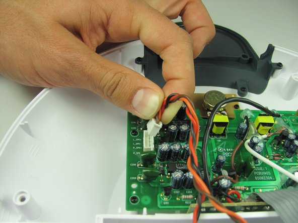

  6. Sharper Image iPulse SI325 DC Input Replacement: crwdns2935265:06crwdnd2935265:01crwdnd2935265:02crwdne2935265:0 Sharper Image iPulse SI325 DC Input Replacement: crwdns2935265:06crwdnd2935265:02crwdnd2935265:02crwdne2935265:0
    • Next, disconnect the speaker wire from the motherboard by gripping the wires as close to the connection as possible and pulling the connector out.
    • Moving the connector back and forth as you pull will make removal easier.

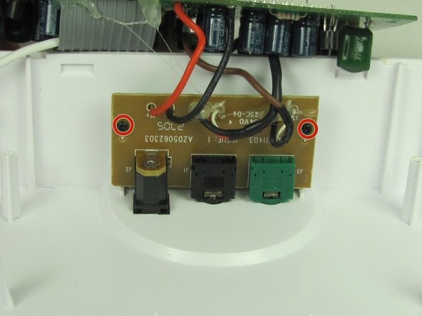

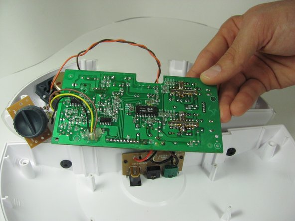

  7. Sharper Image iPulse SI325 DC Input Replacement: crwdns2935265:07crwdnd2935265:01crwdnd2935265:01crwdne2935265:0
    • Remove the two 11mm Phillips #1 screws attaching the small brown circuit board to the plastic case.
    • Also remove the four 11mm Phillips #1 screws attaching the motherboard to the plastic case.
  8. Sharper Image iPulse SI325 DC Input Replacement: crwdns2935265:08crwdnd2935265:01crwdnd2935265:03crwdne2935265:0 Sharper Image iPulse SI325 DC Input Replacement: crwdns2935265:08crwdnd2935265:02crwdnd2935265:03crwdne2935265:0 Sharper Image iPulse SI325 DC Input Replacement: crwdns2935265:08crwdnd2935265:03crwdnd2935265:03crwdne2935265:0
    • Lift up on the motherboard and light intensity dial circuit board to expose the circuit board containing the auxiliary input, sub input, and DC input.
    • Remove the two 7mm Phillips #1 screws attaching the brown circuit board with all of the inputs.

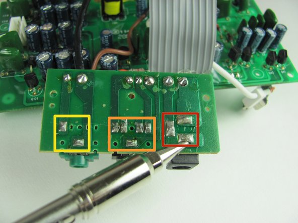

  9. Sharper Image iPulse SI325 DC Input Replacement: crwdns2935265:09crwdnd2935265:01crwdnd2935265:02crwdne2935265:0 Sharper Image iPulse SI325 DC Input Replacement: crwdns2935265:09crwdnd2935265:02crwdnd2935265:02crwdne2935265:0
    • Lift up the circuit board containing the Auxillary, DC, and sub inputs and move the lower case out of the way.
    • Turn the circuit board over so the solder is visible. Depending on which input is broken remove the solder connecting either the Auxillary, DC, or Sub input.
    • DC input
    • Auxillary Input
    • Sub Input
