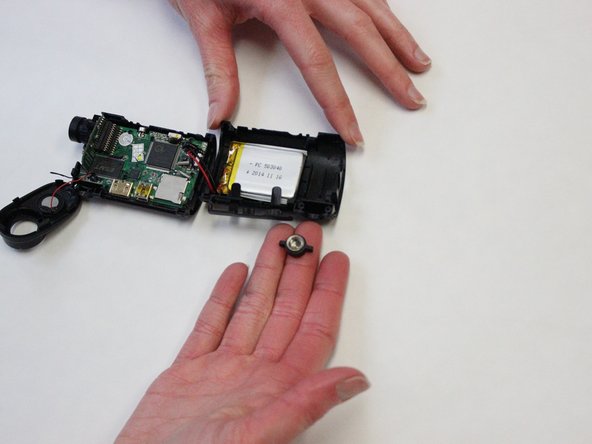

  11. Sharper Image SVC430 Tripod Nut Replacement, Tripod Nut: crwdns2935265:011crwdnd2935265:01crwdnd2935265:01crwdne2935265:0
    • Locate the two screws that attach the tripod nut to the device.
  12. Sharper Image SVC430 Tripod Nut Replacement: crwdns2935265:012crwdnd2935265:01crwdnd2935265:02crwdne2935265:0 Sharper Image SVC430 Tripod Nut Replacement: crwdns2935265:012crwdnd2935265:02crwdnd2935265:02crwdne2935265:0
    • Unscrew the two screws located on the back of the half that the tripod nut is located.
    • Once the screws are removed, the tripod nut can easily be removed.
