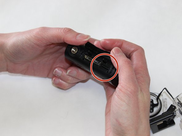

  3. Sharper Image SVC430 SD Card Replacement: crwdns2935265:03crwdnd2935265:01crwdnd2935265:02crwdne2935265:0 Sharper Image SVC430 SD Card Replacement: crwdns2935265:03crwdnd2935265:02crwdnd2935265:02crwdne2935265:0
    • Locate the micro SD port at the bottom of the device by lifting up the panel.

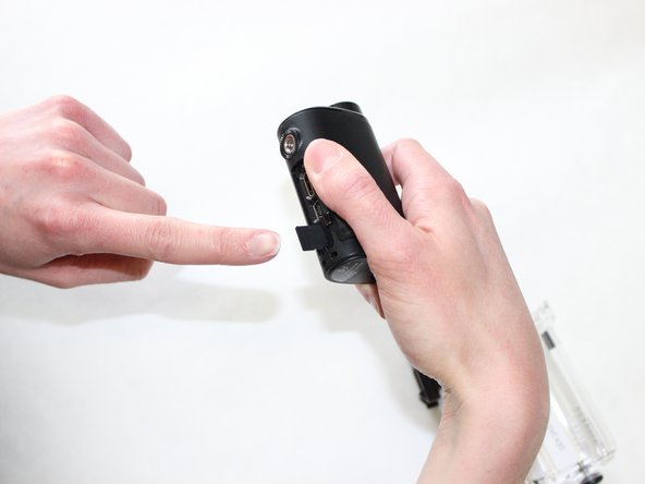

  4. Sharper Image SVC430 SD Card Replacement: crwdns2935265:04crwdnd2935265:01crwdnd2935265:02crwdne2935265:0 Sharper Image SVC430 SD Card Replacement: crwdns2935265:04crwdnd2935265:02crwdnd2935265:02crwdne2935265:0
    • To remove the micro SD card from the device, gently push the SD card and release. The SD card will pop out.
    • Be sure to gently push the SD card, pushing harder than necessary can cause the SD card or port to break.
