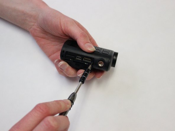

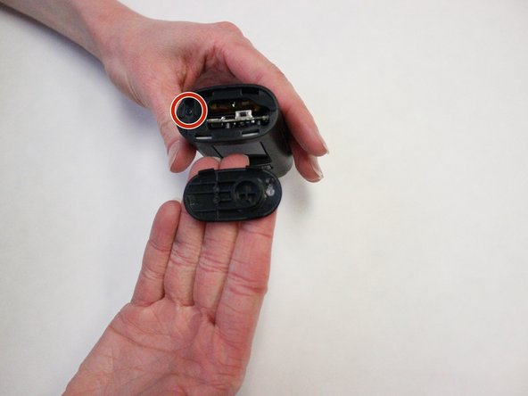

    • Locate the bottom of the device.
    • Now, using the metal screwdriver, unscrew the screw on the bottom of the device.

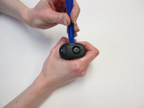

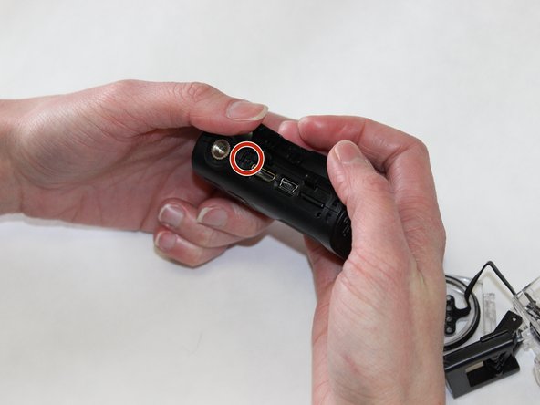

    • This panel should come off easily, do not apply too much pressure.
    • Use the plastic opening tool to pry open the plastic panel from the top of the camera.

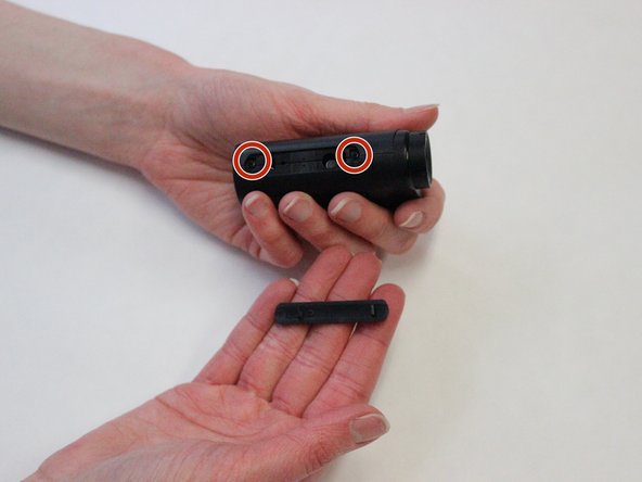

    • Locate the two screws on the top of the device.
  5. Sharper Image SVC430 Lens Replacement: crwdns2935265:05crwdnd2935265:01crwdnd2935265:01crwdne2935265:0
    • Use the JIS J0 screwdriver to unscrew the two screws on the top of the device.
