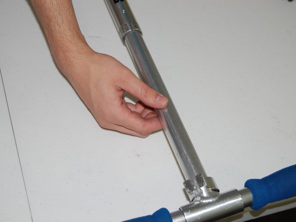

    • Now that the retaining clip has been freed, slide it off towards the handlebars. (Picture 1)
    • Once the retaining clip is removed the handlegrip "T" will now easily slide out of the scooter base. (Picture 2)

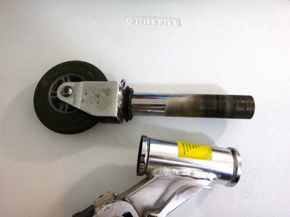

    • Moving down the remaining scooter shaft, use a 5mm allen key to remove the lower retaining ring. (Picture 1)
    • Now remove the remaining scooter shaft by unscrewing it from the the wheel and axle. (Picture 2)
    • Hint: Hold the front wheel while unscrewing the shaft to prevent the axle from spinning.

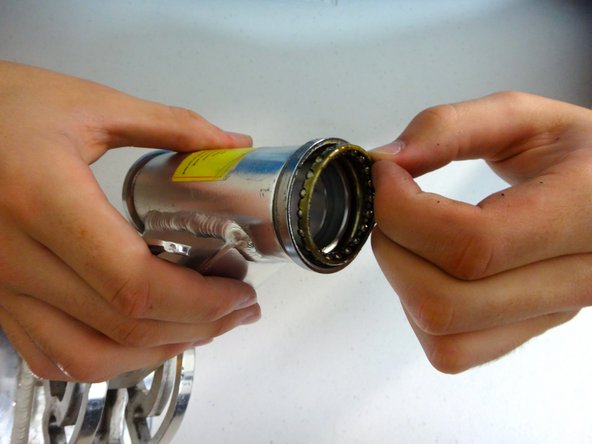

    • Now carefully remove the bearing sitting inside of the axle housing. (Picture 3)

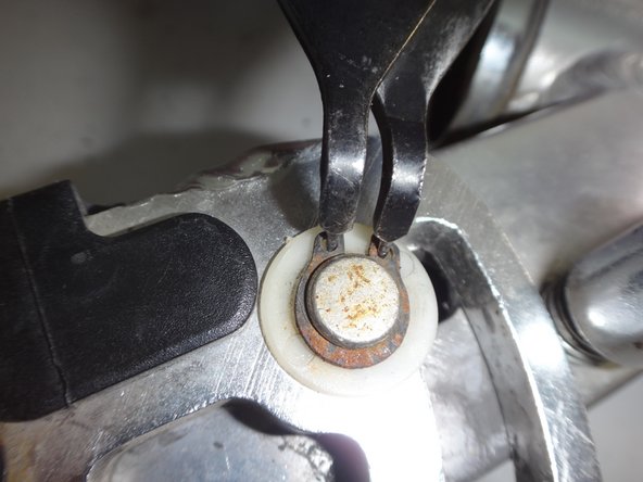

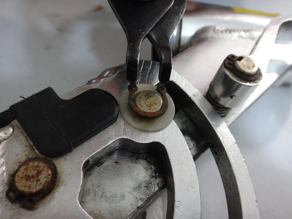

    • Remove all six snap rings from the pivoting assembly. The process for using snap ring pliers is shown in Pictures 1-3.
    • Hint: Three snap rings are shown in Picture 1. The remaining three are on the other side in the same location.
    • Note: It is recomended to wear eye protection during this step since snap rings have a tendency to spring all over the place.
