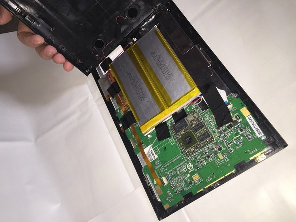

  4. Sharper Image M18A Speaker Replacement, Separate the Tablet: crwdns2935265:04crwdnd2935265:01crwdnd2935265:02crwdne2935265:0 Sharper Image M18A Speaker Replacement, Separate the Tablet: crwdns2935265:04crwdnd2935265:02crwdnd2935265:02crwdne2935265:0
    • Snap the back cover of the tablet off of the front cover, hence removing the tablet’s outer casing. Be cautious when removing because the speaker wires connect the two casings of the tablet.

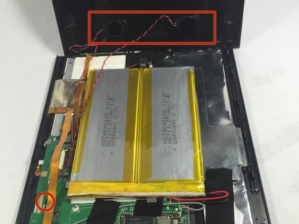

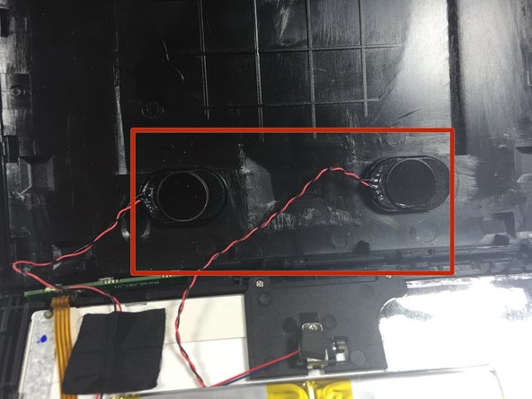

  5. Sharper Image M18A Speaker Replacement, Identifying the Speakers: crwdns2935265:05crwdnd2935265:01crwdnd2935265:01crwdne2935265:0
    • The speakers are located on the inside of the back casing. They are two small black ovals thats are connected with two sets of black and red wires and connect to the logic board.

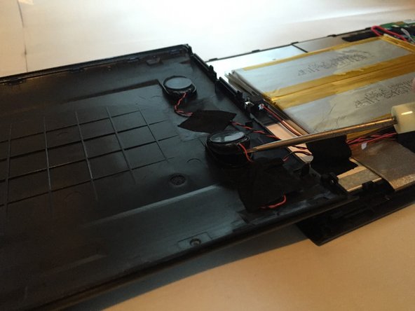

  6. Sharper Image M18A Speaker Replacement, Removing the Speakers: crwdns2935265:06crwdnd2935265:01crwdnd2935265:02crwdne2935265:0 Sharper Image M18A Speaker Replacement, Removing the Speakers: crwdns2935265:06crwdnd2935265:02crwdnd2935265:02crwdne2935265:0

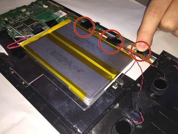

    • Using a prying tool lift the edge of the speakers where the wires are attached. Follow the wires connected to the speakers and remove the black tape. There is one piece of tape for each speaker and three pieces of tape that attach them to the logic board. Remove all carefully.
