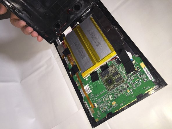

  4. Sharper Image M18A Battery Replacement, Separate the Tablet: crwdns2935265:04crwdnd2935265:01crwdnd2935265:02crwdne2935265:0 Sharper Image M18A Battery Replacement, Separate the Tablet: crwdns2935265:04crwdnd2935265:02crwdnd2935265:02crwdne2935265:0
    • Snap the back cover of the tablet off of the front cover, hence removing the tablet’s outer casing. Be cautious when removing it because the speaker wires connect the two casings of the tablet.

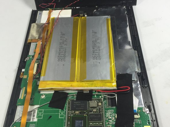

  5. Sharper Image M18A Battery Replacement, Identifying the Battery: crwdns2935265:05crwdnd2935265:01crwdnd2935265:01crwdne2935265:0
    • Upon opening the device the battery is clearly visible, on the side of the logic board. It is a silver rectangular shaped battery with yellow tape around the border and is attached to a silver metal plate, which holds the battery in place.

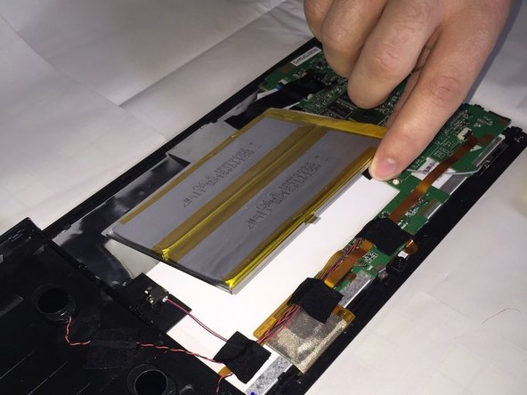

  7. Sharper Image M18A Battery Replacement, Removing the Battery: crwdns2935265:07crwdnd2935265:01crwdnd2935265:02crwdne2935265:0 Sharper Image M18A Battery Replacement, Removing the Battery: crwdns2935265:07crwdnd2935265:02crwdnd2935265:02crwdne2935265:0
    • Peel off any tape holding the battery or tray and then find the red and black wires located on the corner of the battery that is soldered to the logic board.
    • Using the wire snippers, cut the defective battery wires as close to the circuit board as possible.
    • Then proceed to lift the battery out of the tablet.
