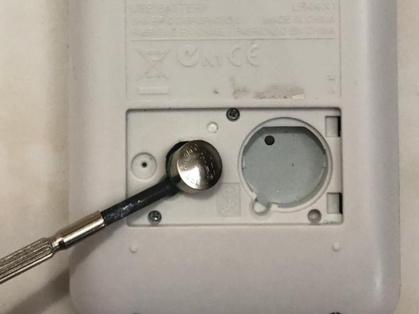

  4. Sharp-EL-531xg Battery Replacement: crwdns2935265:04crwdnd2935265:01crwdnd2935265:03crwdne2935265:0 Sharp-EL-531xg Battery Replacement: crwdns2935265:04crwdnd2935265:02crwdnd2935265:03crwdne2935265:0 Sharp-EL-531xg Battery Replacement: crwdns2935265:04crwdnd2935265:03crwdnd2935265:03crwdne2935265:0
    • Place a spudger in the slot next to the battery and pry upwards to remove the battery.
    • Avoid using a sharp tool to remove the battery.

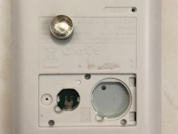

  5. Sharp-EL-531xg Battery Replacement: crwdns2935265:05crwdnd2935265:01crwdnd2935265:01crwdne2935265:0
    • Place the new battery into the slot with the positive (+) side facing upwards
    • Don't press the battery too hard.

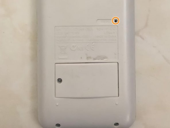

  7. Sharp-EL-531xg Battery Replacement: crwdns2935265:07crwdnd2935265:01crwdnd2935265:02crwdne2935265:0 Sharp-EL-531xg Battery Replacement: crwdns2935265:07crwdnd2935265:02crwdnd2935265:02crwdne2935265:0
    • Press the On button to turn on the calculator.
    • Flip the calculator over so the bottom is facing upwards.
    • Press the reset button with the pointed end of a spudger to restart the calculator.
