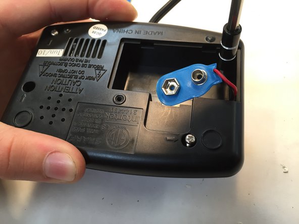

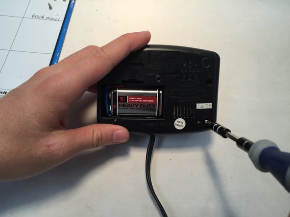

      • Locate and remove the screws found underneath the alarm clock.
      • Separate the bottom and top of the alarm clock by pulling them apart.

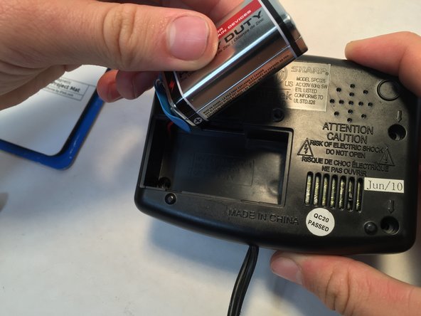

      • Disconnect the battery.

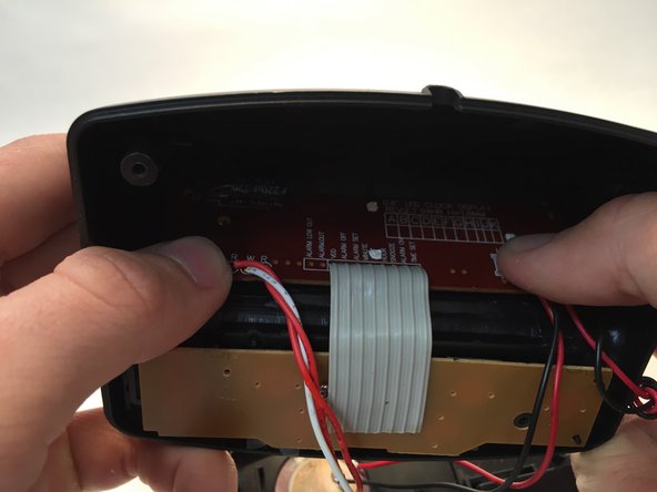

      • Find and remove the button pad on the back side, and locate the broken metal button.
      • Gently lift the tape and the button will come off.
      • Replace the old snooze button with the new one and reattach the tape.
